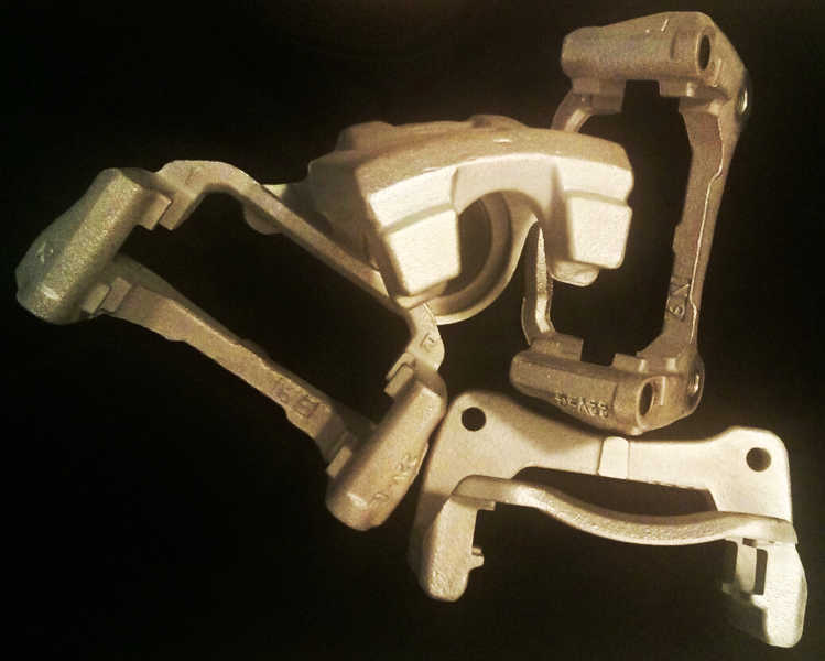

    I'm starting to wonder if some of that is just generalized gummint's-always-wrong grumpiness. A few years ago I found this chart of Toyota plating specs:
    You can see where the old 6500G standards were obsoleted and replaced by the 6524G ones that are free of hexavalent chromium (the aforementioned health concern). From all the grumbling about the phase-out, you would expect the salt-spray hour ratings to be a lot lower for the new stuff, but notice you really don't, in fact the new stuff is darned good. It really shows up in the thinnest coatings: see how a five micron plate of the 6524G has almost three times the hours-to-red-rust as the old must-have-been-better-because-it-was-phased-out stuff?
    Wouldn't you love to have some stuff plated in zinc-nickel though? Get a load of those salt-spray hours. My local plating shop doesn't do any, though.
    -Chap

    I hear you. I just, looking at that chart, am skeptical that much of it really boils down to the "everything was dandy back when Cr(VI) didn't cause cancer" kind of narrative.
    I figure it must come down more to just the everyday economic decisions Honda and Toyota must be making about which thickness of which treatment to spec for which parts.
    I discovered the electroplating shop in town, who did a lovely job replating some old brake hardware for me. I'm curious about e-coating and keep looking for a shop that does that and will take one-off jobs, but so far, none I've tried return my messages.
