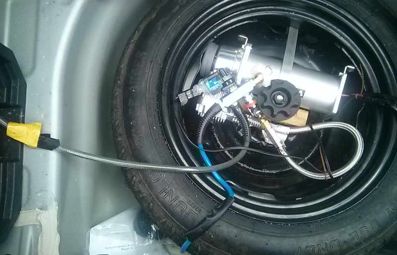

    This recently occurred to me:
    Looking through the technician instructions for this, there's no way to miss how hard Toyota is trying to avoid any possible power dip during reflashing that could lead to a bricked ECU.
    They require a 12 volt power supply (not just a charger) to be hooked to the car's battery. They require the laptop running Techstream to be fully charged or plugged in, or both. They make sure the brake system is at full pressure before starting so the hydraulic pump shouldn't come on and draw power during the test, and they remove three high-amp fuses to prevent things on those circuits from happening.
    That made me think: if you have any aftermarket, high-amp things you've added to the car that the dealer isn't going to know about, you probably want to make sure those are disabled before taking the car in for the reflash. I will definitely pull the fuse for my onboard air, for example.
    Also, I see they aren't pulling the fuse for the brake pump. but just using the brakes until it runs, so they know the accumulator has been freshly pumped up.
    Which would mean, if you've been noticing any increase in pump frequency lately, or it doesn't seem able to hold for an hour between runs if nobody's using the brakes, you might want to let them know that.

    This recall only involves updating the software in one of the car's ECUs. It is done by plugging a laptop in to the car's diagnostic port, and telling Techstream on the laptop to install the updated software version. In the bird's-eye view, that's all that's involved.
    (Ok, I simplified: they will actually update more than one piece of software, if the car did not have the previous inverter-related software recall, or if it did but one of the updates was missed then, which happened to about 36,000 cars.)
    Now. Why do they have a bunch of elaborate rituals around that simple update?
    It turns out there is one thing you really do not want to happen while you are in the middle of updating software in a car's ECU (or your phone, or your internet router, or most things nowadays that have embedded software in them).
    You don't want the power to go out in the middle of replacing the software.
    If that happens, the device doesn't work. It doesn't have its complete software. It's overwritten up to some place in the middle. You generally don't get another try at uploading the update, because the ability to upload an update was part of the software, which the device now doesn't have. Such a device is usually referred to as "bricked" ... as in, now it's as useful as a ....
    The dealership does not want to brick one of your car's ECUs when you brought the car in for a simple recall. When the update goes right, all they have to do is plug a laptop in to a plug below the dash, run the update, and unplug it. If the ECU gets bricked, now suddenly a tech has to come take the dash apart and remove the bricked ECU and replace it with a new one and put the car back together, all while you're wondering why the recall is taking so long. The dealer would much prefer not to eat that labor cost, not to mention the cost of the ECU.
    So they really, really don't want the software update to get interrupted in the middle.
    How do they avoid that? Well, it's all about eliminating as many possible causes of power dips as they can.
    So the Techstream laptop has to have a full charge before they start. Or be plugged in. Better yet, plugged in and with a full charge, so it can keep going in case the dealership power goes out.
    They won't start the update until they have connected a plugged-in 12 volt high-amp power supply and jumped it to the terminals of your car's own battery.
    And they won't start the update until they have taken steps to prevent various things your car normally does that use heavy battery power. They pull three large fuses out of your car's fuse box so the things they control aren't going to maybe come to life in the middle of the update and suck the power down.
    And one other thing that uses heavy 12 volt power is the pressurizing pump for the brake system. If they don't know how much pressure is in the system when they start, that pump might come on at any time during the procedure (it's the little whirring sound you're used to hearing under the hood, often right after using the brakes).
    So how to make that less likely to happen? They just push the brake pedal a bunch, to use up pressure until the pump is triggered to come on. Then they wait for the pump to stop. That means the system is right now at full pressure, and the pump will probably not need to come on again, within the time they need to complete the update.
    That's the only thing that "brakes" have to do with this recall at all. The recall is nothing but software updates, and they are just taking standard precautions to not have the software update get interrupted in the middle.
    More or less the same precautions are in any of their recalls or service bulletins that involve updating software in any of the car's ECUs. It doesn't mean the procedures all have something to do with the brakes. These are just precautions against sudden electrical drains that could happen during a critical update.
    The main reason I posted #26 was just to say, hey, if you have added any kind of aftermarket heavy electric load in your car (like the air compressor example in mine) and the dealer won't know about it or know how you disconnect it, probably you want to disconnect it yourself before going in for the recall. Because everybody's happier if the car's computers don't get bricked during what's supposed to be a quick in-and-out job.
    Also, there are some people driving around with known brake system problems where they hear the pump running way more often than normal, but haven't had it fixed yet. If you're one of those people, let the dealership know before they start a software-update procedure! If they can't trust your pump to run once and stay off for an hour, they'll want to know that.
    One other thing, they're probably happy if you show up for one of these updates without a whole lot of stuff packed in the hatch area, because they need to pull up the deck boards to get to your battery and attach the supplemental power supply.
    See the link I put in #25 for how you can check the software versions in the car and make sure you have the right ones after the service.
