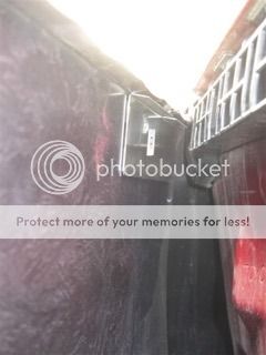

    Finally did some research and found various solutions today. I'm ordering new side support brackets:
    Drivers side:
    Passenger side:
    Here's how they go in:
    There is also an additional stainless reinforcement piece available from Kenstyle Japan that supports the rearmost portion of the bracket by adhering to the bumper cover and sliding over the top of the side retainer. Hard to get unless you have a contact in japan or want to pay crazy shipping fees. Not hard to make though:
    KENSTYLE 純正リアバンパー用 補強プレート|PRIUS/TOYOTA|Parts Reviews|チャンモリ|Minkara - The Car & Automobile SNS (Blog - Parts - Maintenance - Mileage)
    Here's how it goes on:

    If someone can post the dimensions of that bracket I could draft up a nice pdf and post it.
    It's interesting in the video, the troubles with the "jacking point". Toyota does not reinforce that point adequately (if at all). He'd be better off just using the rear central jacking point, raise the whole rear. Just inboard of the official (and woefully inadequate) jacking points, there is a heavily reinforced zone, better for jack stands.
