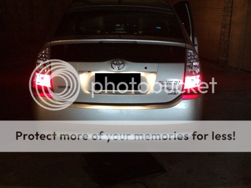

    for the taillight ones that i used, all i had to do was to order the error free types.
    these draw the same current as regular globes. so you don't save power,
    but they don't cause errors with the cars systems either.
    EDIT: i should also point out that the ones im using are not the pinkish color that the phone camera makes them appear to be. they are a nice red color. and they are about the same brightness as the stock globes too. maybe a touch brighter, but not much.
    Jason
