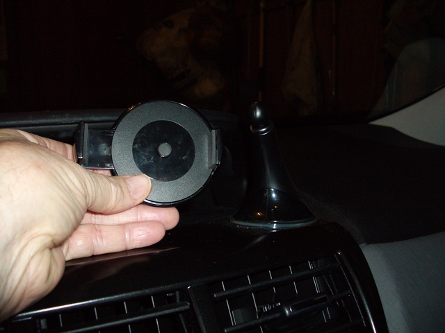

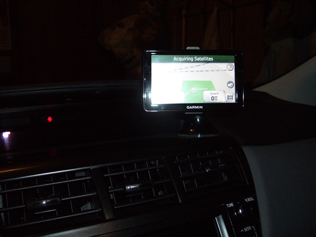

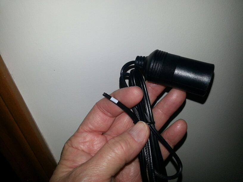

    While I appreciate the integration of the in-dash navigation systems in our Prius v and Sienna van, our inexpensive two year old Garmin sat nav units are easier to use -- excellent voice recognition and hands-free phone; lifetime free updates and traffic monitor with rerouting.
    The attached photos show the iOttie Easy View mount that my wife normally uses to hold her iPhone in her Prius v. The Easy View mount series has a 17mm ball that is compatible with Garmin. Remove the phone holder from the Easy View, press on the Garmin holder and you are set to go unless you want to hide the Garmin's power cord/traffic receiver in the dash. An attached photo shows the type of socket adapter (cost about $5) I have used when hardwiring a Garmin to a vehicle's accessory circuit so that the Garmin powers on and off with the ignition. I have found that recent model Garmin traffic receivers work fine even when hidden deeply in a dash.
    iOttie Easy View - 640x480.jpg iOttie Easy View with Garmin - 640x480.jpg Socket adapter.jpg
    Of course you could instead affix a 3M adhesive disc to your dash and then attach a portable sat nav suction cup to it. The coolest feature of iOttie holders is that their sticky suction discs will adhere well to even a textured dash on their own, are easy to remove and do not leave a residue: iOttie Series_EasyView An iOttie would allow you to experiment with the best mounting position. A 3M adhesive disc can only be used only one time and can leave a residue when removed.
    Since your car salesman made a mistake, perhaps they would hardwire a portable sat nav for you. With their knowledge of your vehicle, it should take them only a few minutes.
