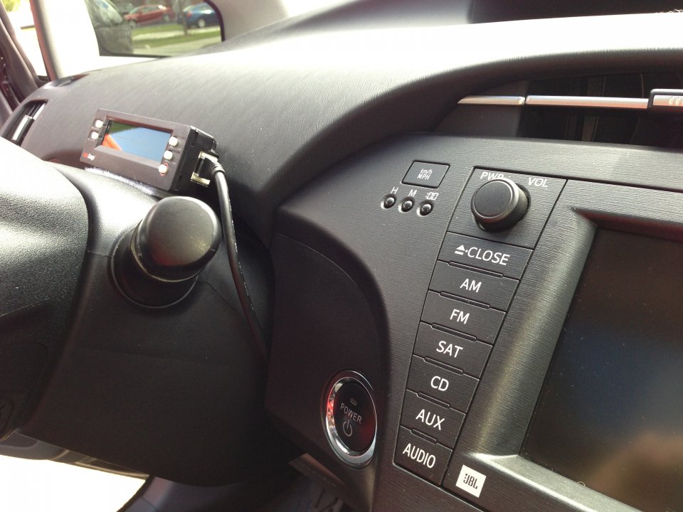

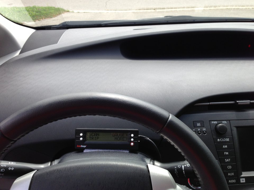

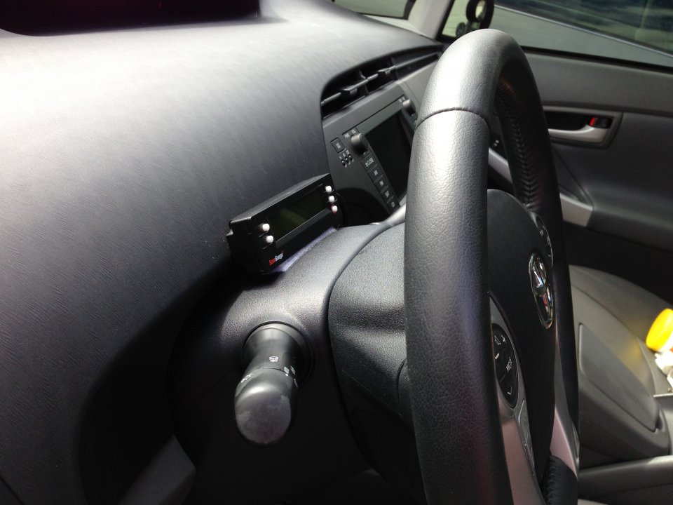

    It plugs in the OBD Port. I placed mine ontop of the steering column against the dash with velcro, so it can be removed later. Then I ticked the cable behind the column so it's hidden. I can post pics if you want. Really easy to do, and it's always in front of me, but not distracting. Glad you got the Autozone deal. I wasn't able to, as I'm in Canada. Wanted one for my wife's "C"

    It works great, and it's not perminent. You can take it out anytime, and there won't be a mark left. It's been installed like that for 2 years now, and no issues.

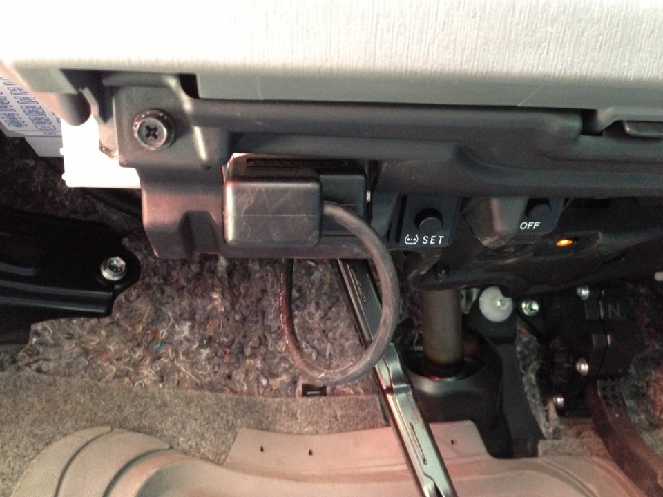

    Hey again! There is a plate (with a 1/2 inch opening) above the OBD socket where you thread the cable through and then you can roll up and I just used 2 ties and tucked 3 or 4 loops of extra cable above the same plate . You thread from the OBD up, not from the steering wheel down. It really is self intuitive once you go to the car and look at it and took me about 3 minutes to figure it out. I would buy an extra cable if you want to have it in 2 cars. Pictures would not be helpful because cable is hidden, sorry. Once you have the cable you honestly will have no problem! Enjoy.
