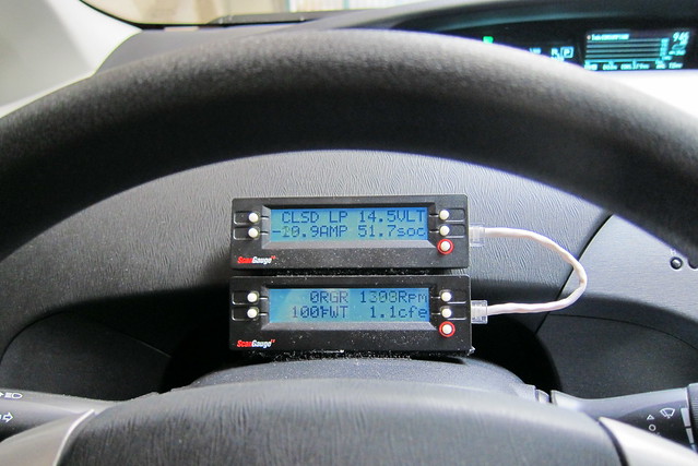

    I have a OBD-II Y cable which goes from the connector under the dash to two OBD-II connectors. You can find them at various resellers on the web. But you don't need that for the ScanGauge II. Just use a regular CAT-5 ethernet cable and you can connect more units. I have run 3 at one point and it works perfectly. You can use the side or back jack interchangeably too.
    I normally run two of them. Here is a picture I took this morning.
    I got a wiring contractor at work to make a short little ethernet cable for me. (The white cable)
    Robert Holt likes this.

    Oh, there is one caveat to running more than one SGII. Before you unplug them from the connector under the dash, unplug the last unit from the chain (when running two) then you can unplug the connector under the dash.
    What happens is the last unit sucks away reserve power from the middle unit and all of the settings get reset. (Not your XGAUGEs but all your other settings.) Unplugging the last unit first prevents this from happening.
    Oh ya -- also, you can run both at CAN with the RATE set to fast and it works perfectly. The only thing that sucks is if the units ever sit there say "Connecting" they will slow down their rate. I find this happens when you first plug them back in. Go back to RATE and set it back to FAST.
