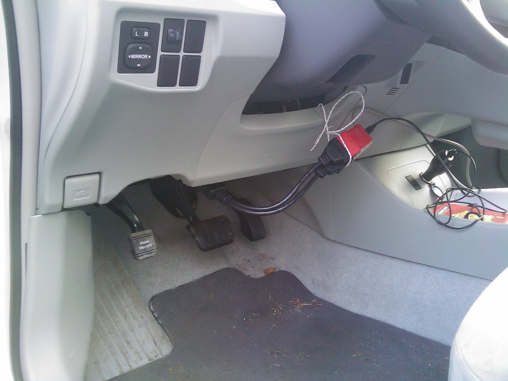

    Ummm, guys, this worked!! I took a (crappy) video on my iPhone and posted it to Youtube:
    Edit: Uploaded new video of me controlling it directly
    I'm so surprised really. I tried sending commands and that did nothing. I also put in the XGAUGE to query the status and that didn't work -- just showing up blank.
    This rocks!! Here's what I did:
    Programmed XGAUGE
    Had car in READY mode, driver's door closed
    Activated XGAUGE for this and left it up for a couple of seconds.
    Only showed up as blank
    Switched to another XGAUGE
    Put car into reverse -- only one beep!
    RobH, I think this deserves a new post to get the word out.
    Edit: Here are the two Xgauge's I used:
    Query Reverse Beeper (shows 0000 is enabled, 0040 is disabled)
    TXD: 07c021ac
    RXF: 046115ac0000
    RXD: 2808
    MTH: 000100010000
    Set Reverse Beeper Off
    TXD: 07c03bac40 (change last 40 to 00 if you want to re-enable it)
    RXF: 047b15ac0000
    RXD: 2008
    MTH: 000100010000
