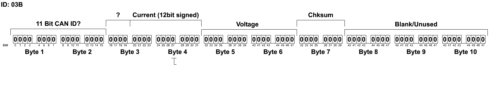

    First, lets understand exactly where the data is:
    Prius PHEV TechInfo - EAA-PHEV
    Lets look at the first row of data. First of all, I have no idea why they numbered the byte position the way it is layed out on the table... so I've simplified it a bit... Note: may not be accurate, but it's the best explanation I've been able to come up with.
    http://i11.photobucket.com/albums/a199/Bobc64/prius/priuspassivecan-1.gif
    We're interested in Bytes 3 and 4. Note that Current is 12 bits and that it is signed.
    Signing means that the most significant binary bit - when set - results in its value being negative.
    For example, in an 8 bit binary number 1111 1111, to convert into decimal you add -128 + 64 + 32 + 16 + 8 + 4 + 2 + 1 = -1.
    It also means that bits 16-19 are unneeded.

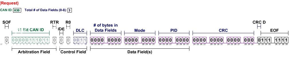

    I've actually found that CAN specs sheet linked from wikipedia before you posted, and judging by the content there. I believe the Data Bytes section of EAA-PHEV wiki is incorrect.
    Specifically Byte 2, since an ID requires more then one byte (3 hex characters) to fit... so I don't think its physically possible to stick the ECU id into 8 bits.
    I'm actually programming a simple "CAN packet" simulator thats slightly interactive. To help people visualize what is being sent... However I'm also trying to figure out if it also corresponds to the scangauge xgauge programming guide that linear logic has released. The part I'm a bit confused on is the RXF, since it doesn't seem to match up with the official specs of the CAN.
    Work in progress:
    http://i11.photobucket.com/albums/a199/Bobc64/prius/can.jpg
  18. jayman
    jayman Senior Member
    Oct 21, 2004
    13,439
    641
    Winnipeg Manitoba
    No, that doesn't look right. Wondering if there is a typo on their part?
