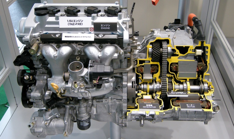

    Here's the most interesting one today, this was from a cold start, notice how the MG1's motor temp rises well above what MG2 is doing. Is this because MG2 has better cooling? It also indicates that both inverter circuit temps are well cooled. The 03 Prius is next.

  7. bwilson4web
    29,112
    16,554
    MG2 is on the end of the transmission, nothing but air around the end and all sides. In contrast, MG1 is between the engine block and gears. MG1 normally running pretty close to engine coolant temperature and seems to be happy there.
    What we find is when MG2 develops a fatal short in the stator coils, its temperature rises above MG1. It can sort of continue to run for a little while and there will be a speed related "humming" but it is burning itself up at that point. Time to find a salvage transmission.

    Thanks Bob, very interesting indeed. And it makes sense that MG1 would get hotter in the beginning because it's right next to the ICE and also less air flow in the middle of the transaxle/engine. MG2 is towards the outside of the transaxle and therefore gets good air flow. Did you get your scantool yet? Tom

    That's not why MG1 often gets hotter than MG2 during a cold start and warmup. The engine in the Prius produces less waste heat than a typical passenger car engine, and contributes little to MG1 temperatures.

    would it be because the engine is starting up requiring the MG1 to spin up to ~3600 rpm-3900 rpm to spin the engine to like ~ 1200 rpm?

    In one respect, MG1 will be running anytime the ICE is producing power. MG1 provides the counter torque needed to pass ICE torque on to the ring gear:
    But the easiest reason is to observe that the engine coolant will be between 82-90C depending and is firmly mounted on one side of the transaxle housing next to MG1. The other side of MG1 has MG2, which has only the circumference as well as the end plate to dissipate heat. The Dept. of Energy report from UT Battelle identified the surface as being the primary cooling mechanism followed by the coolant channels.

    Not entirely; that takes less than a second. But MG1 continues to spin for during cold start and warmup for a variety of reasons, while MG2 is not doing much of anything. Basically, MG1 is usually working harder than MG2 during this time. That's really all there is to it.

    Sure that's not 82º-90ºC?
    If MG1 temperature was significantly affected by engine temperature, it would not fluctuate as much as it does during a typical drive cycle, which it does even though it's almost always spinning.

    This is a partial fractions question with part from the motor losses and part from the thermal transfer of heat through the cases. The rapid MG1 temperature changes come from the motor resistance losses which will be proportional to the ICE power. Roughly:
    ICE_power * 28% ~= MG1_power
    MG1_power * (100 - 97) ~= MG1_waste_heat
    This assumes a 97% efficiency in the motor although in reality it is a non-linear function. The resistance heating will be proportional to the current squared so higher power settings will significantly, rapidly increase MG1 temperature. However, MG1 power is mostly provided to or received from MG2. This load dependent, heat load will apply to both MG1 and MG2. So this leave the case transfer heat load.
