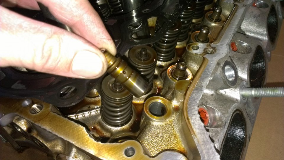

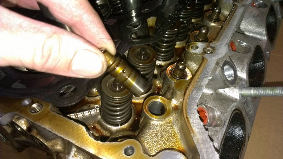

    G3 engines have hydraulic valve adjusters.

    Forgot the 1.8 has hydraulics. That's why its not so noisey on 0-20. The Gen2 1.5 has solids and it makes quite a racket on 0-20 imho. Even with M1 0-20.

    Gee.
    I'd love to know why THAT picture was taken! :D

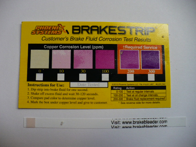

    You guys were scaring me with your 36 month brake flushes so I bought a brake test kit like Rude person's uses.
    Below please see the results of my Gen2 I P1010557.JPG P1010557.JPG bought new in 07 and has 66,000 miles. Brake fluid never changed.
    Almost O PPM's copper detected.
