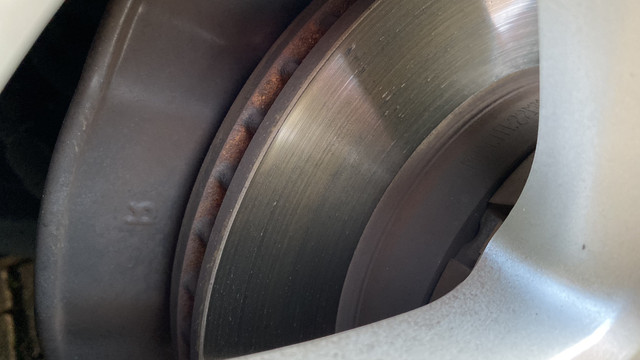

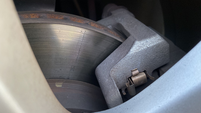

    Attached are a couple of photos I have just taken now of my front offside side.
    I hope this helps.

    Thanks. That does help.
    I'll keep a close eye on the discs, maybe get them independently checked by someone I trust just to be sure.
    At the end of the day they work very well at stopping my car, but with a wife and 2 kids I don't want a small brake issue becoming a big one right when I need them.
