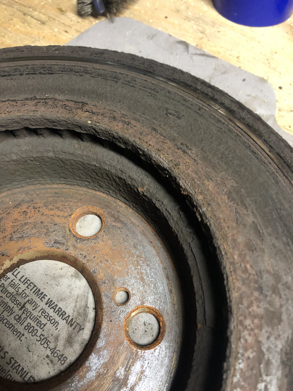

    I have 64000km in the 2017 Prius
    And my front brakes look like crap
    The front of each rotor is full of small groves and the rear side of front rotor has much larger deeper grooves I can notice without disassembling.
    that said I’m going to pick up new rotors shims and pads and do a brake service with intention to lube all pins and possibly replace everything upon inspection.
    Is there anything I should know about other then disconnection the 12V battery?
    I’m hoping the pistons are push in and not screw style. ??? Let me know anything I should know pls ??? I have done 4 breaks jobs ever with no issues but never a hybrid

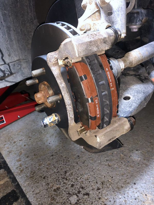

    Disconnect 12 volt negative before starting, and when done, before reconnecting, pump brake pedal a few times to take out any excess travel.
    When pushing in the pads use something (old brake pad, plywood, steel plate) to spread the load evenly over the piston rim: it's some high-tech plastic, can crack.
    Only rear brakes are screw-in caliper pistons, due to integrated parking brake. Do be careful with orientattion of that piston. It's imperative to have piston orientation per pic in Repair Manual, so pin on back of brake pad fits between "spokes" on the piston face (see attached).

    I think you probably are about to waste a LOT of time and money.
    Some "rippling" of the rotors is quite normal and depends mostly on the construction of the pads used.
    Deep gouges, of course, are not normal.
    But it seems like a LOT of people can't tell the difference.
    Have you ever done a complete brake job on a system with ABS and traction control before ?
    The fluid probably should be replaced too while you are at it.

    I have don’t quite a few break jobs, the scoring is not normal. However I have decided to wait for 3 reasons overall braking performance is smooth, even tho the inner pads are way lower and more worn out where the gouges are and a lot more rotor rust present.
    - hate doing brake jobs in the winter cold garage
    - the dealer doesn’t have any brakes pars in stock across Canada... something with Thor warehouse supply. Been on order for 1 month now.

    I changed all the front rotors and pads
    On a 2017 Prius this was surprising.
    This is 2 winters in Ontario plus this one coming.
    The inside pads both wore out way more One metal on metal
    The outside pads also not even
    The pins where not seized but not moving freely. Moving forward after or before every winter I’m going to service them when I change my tires over. Never seen shittier brakes. At 60k

    While I working on the brakes my dad showed up, and sees me working. Then he goes to parts tire and picks up a aftermarket set of raybestos pads. So I did a service on his popped out the old ones still lots of meat left but uneven wear from 1.5mm to 3mm
    To do a service, clean, lube all pins and clips only took 20-30min per side.
    raybesto pads feel fantastic no different from dealer. (But time will tell) for what’s it’s worth $89 for front set is cheap for premium set.
    for the rear I only have that cheap tool for threading the piston. May invest in a better one.
    last 10 years I have not been doing mechanical work myself and went to mechanic for everything but no matter how much the dealer charges they seem to do things sloppy. Overfill oil. Not torque anything they touch. (Not that I torque everything myself) but dealer should.
    they did one break service at about 30k the pins should never have been this seized.
