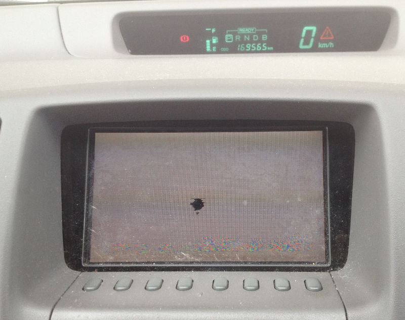

    Well my screen is always on and filled will white pixel. So basically it is of no use me. See the pic.
    Has anyone ever changed this screen? Would like to some suggestions if possible. Otherwise just like to disconnect it completely. In late night driving, it is quite irritating on my eyes.

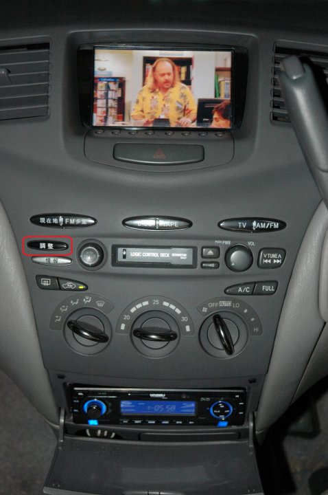

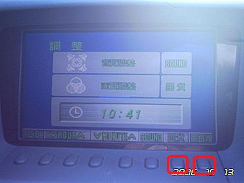

    Method 1
    Press the Display Adjustment button.
    The screen should display something like this.
    The 2nd rightmost button is to adjust the display quality. I can't see the rightmost button description, it could be for turning the display off, you can try it out.

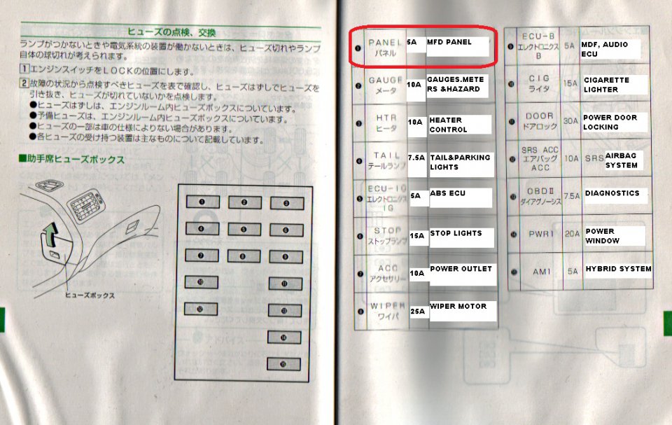

    Method 2
    Pull the MFD fuse. (No. 1 is on the top left corner)
    You can put it back if it does not work or it affects other equipments.

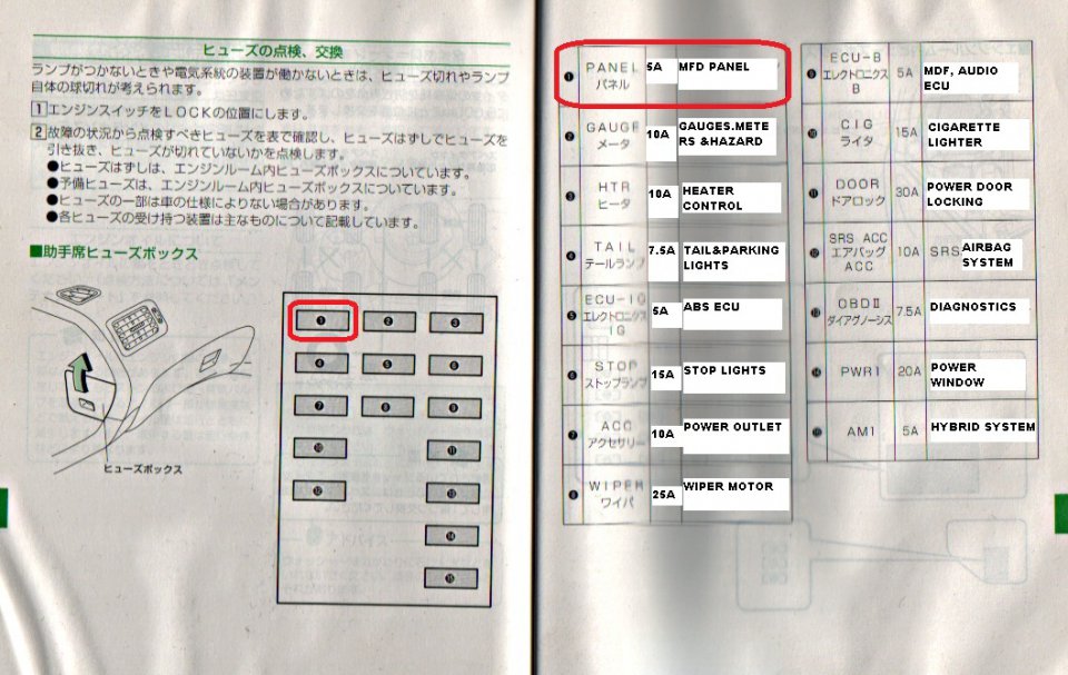

    On the passenger side, swing the door wide open so you can see the cover for the fuse box at the side of the dash. The MFD fuse is located at the top left corner, I 've marked it in red as below.
    Those photos are not mine and I 've mentioned they are taken from the Yahoo MK1 group. It is free and I encourage you to join. The movie I think is from the TV broadcast, there is a TV button next to the AM/FM button. It may only work in JP though.

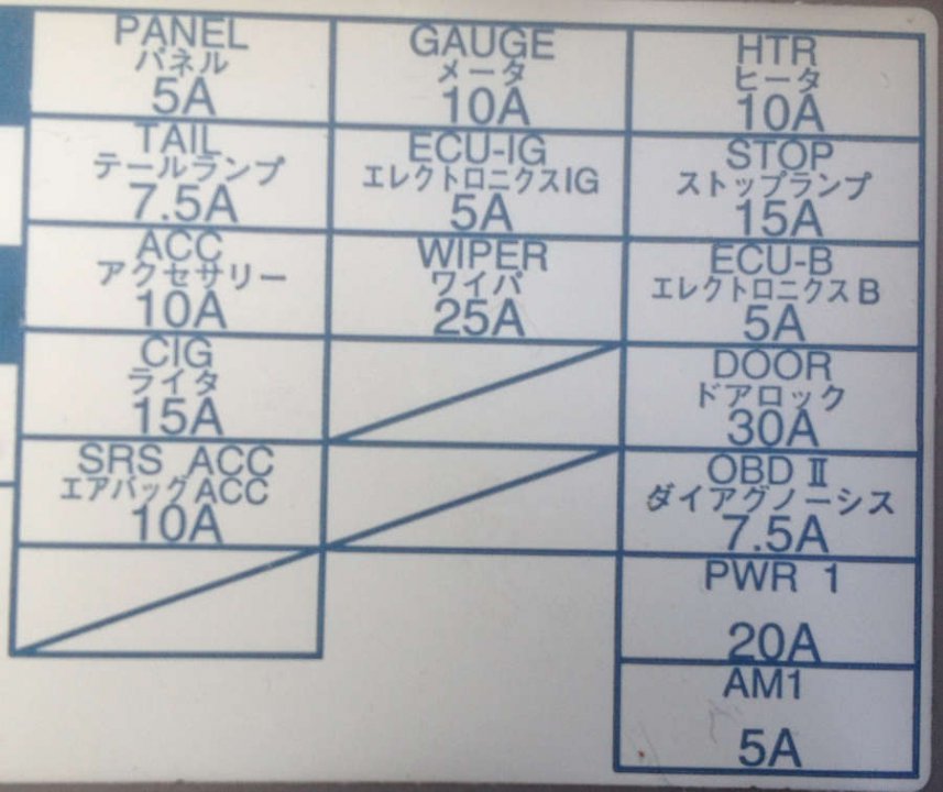

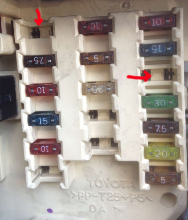

    When I opened that little panel on the left passenger side this is what I found:
    Which is indeed the same what you have posted as well.
    I did take out PANEL Fuse but when I start the car the MFD came to life (bugger????). I then also took out ECU-B fuse (MDF, Audio ECU) as well and started the car. The display as well as the Radio were working. Please see the pic as attached the fuses I took out:
    So do not know really why the MFD was still on. (n)
    Thanks

  12. bwilson4web
    29,028
    16,503
    It is too horrible to contemplate:
    1. Power is coming in via another path
    2. The fuses were somehow tying the B+ from the MFD/Radio to a weak ground, lowering the voltage
    It would be interesting to measure the fuse voltage terminals to ground for each of the removed fuses while the car is ON. You'll need an insulated, longish needle probe. Expected results:
    1. 12V battery voltage, ~13.9 V when car is running on one side.
    2. < 12V battery voltage on the other
    If either side shows something like ground or significantly lower, you've found the bad circuit. Tracing to the fault may be a challenge.
