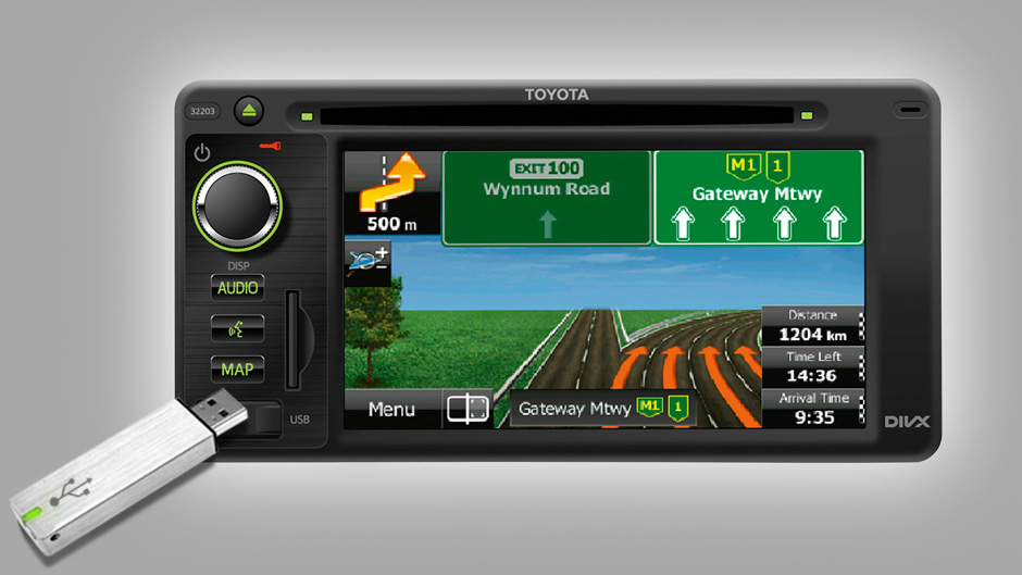

    i bought prius c but audio unit is without SD card.it keeps saying "program loading is necessary please insert SD card" i tried to get the "program" from local market of pakistan, but failed to do so, my prius c is imported from Australia.its audio unit model is 32203 made(fujitsu 10). i m reading prius c forums but again failed to read any related thing.from where can i get "program containing SD card" in Pakistan.can anyone help???

    Does your :AUDIO" has GPS built in and is this an OEM unit?
    Some of the HU uses SD card for GPS program start and do not use DVD.

    yes, it has built in GPS and it is an OEM unit as it is made by fujitsu 10.my unit isn't running anything(back view, radio, audio/video)

    i want SD card 'only'.if this card includes only maps then why other applications(back view, radio, video) are not working??
