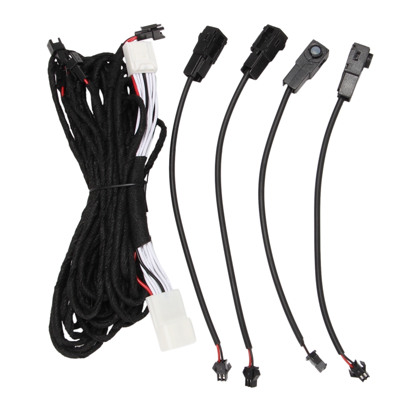

    i spotted a few other foot well light kits offered in aliexpress and mostly are for the highlander and camry. do the white connectors look familiar?

    Looks like a variety of JST connectors.

    just need to find a kit that works with the prius le. hope someone can post a pic of the original harness where the oem foot well lights. maybe one of these aliexpress kits would have a connector that simply plugs in to play. :sneaky:

    From my reading of the wiring diagram, there isn't going to be a simple connector to plug into. The connectors that plug into the LEDs themselves appear to be part of one of the main wiring harnesses. On the XLE/LTD and the Primes, there are 4 wires that come out of either the Power Distribution Box Assembly or one of the junction connectors and they are immediately wrapped into the main harness. The 4 wires become 2 pairs which exit the main harness near the LED locations.
    To add lights to the LE, a person would have to run wires from the PDBA and junction connector to the lights(basically create a sub-wire harness) or bypass the stock way of doing it and tap into some other wires. The first way will give you stock behavior of lights(light up upon unlock, dimming once in D/R); the second way will either involve a manual switch or have cruder behavior(probably no dimming, just on or off).
    I'd be happy to be proven wrong, but the wiring diagram seems pretty clear. I'll attach them. The lights are on page 10(K27 and K28), with the wiring extending into page 11.
