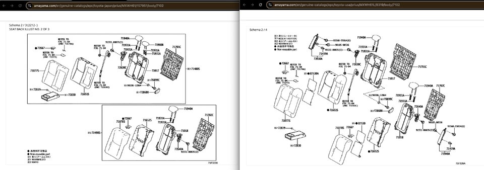

    Pretty sure the rear seats are split the same on both RHD and LHD. Here is a picture of the Japanese Prius rear seat parts diagram and the US parts diagram from amayama.com.

    The split is the same on all the versions. However the soft cover that otatrant imported doesn't work quite as well on the US/Canada version as it was intended to. The US/Canada rear seat has a middle headrest that is part of the seat body. In the rest of the world, the middle headrest is a separate part. The soft cover for the rear seat backs is attached with straps that go around the headrest stalks. Because the middle seat doesn't have those stalks in the US model, the right side cover is only hanging from the right-most headrest instead of being supported by both. Now obviously it still works well enough or otatrant would have said something, but it's something to note.
