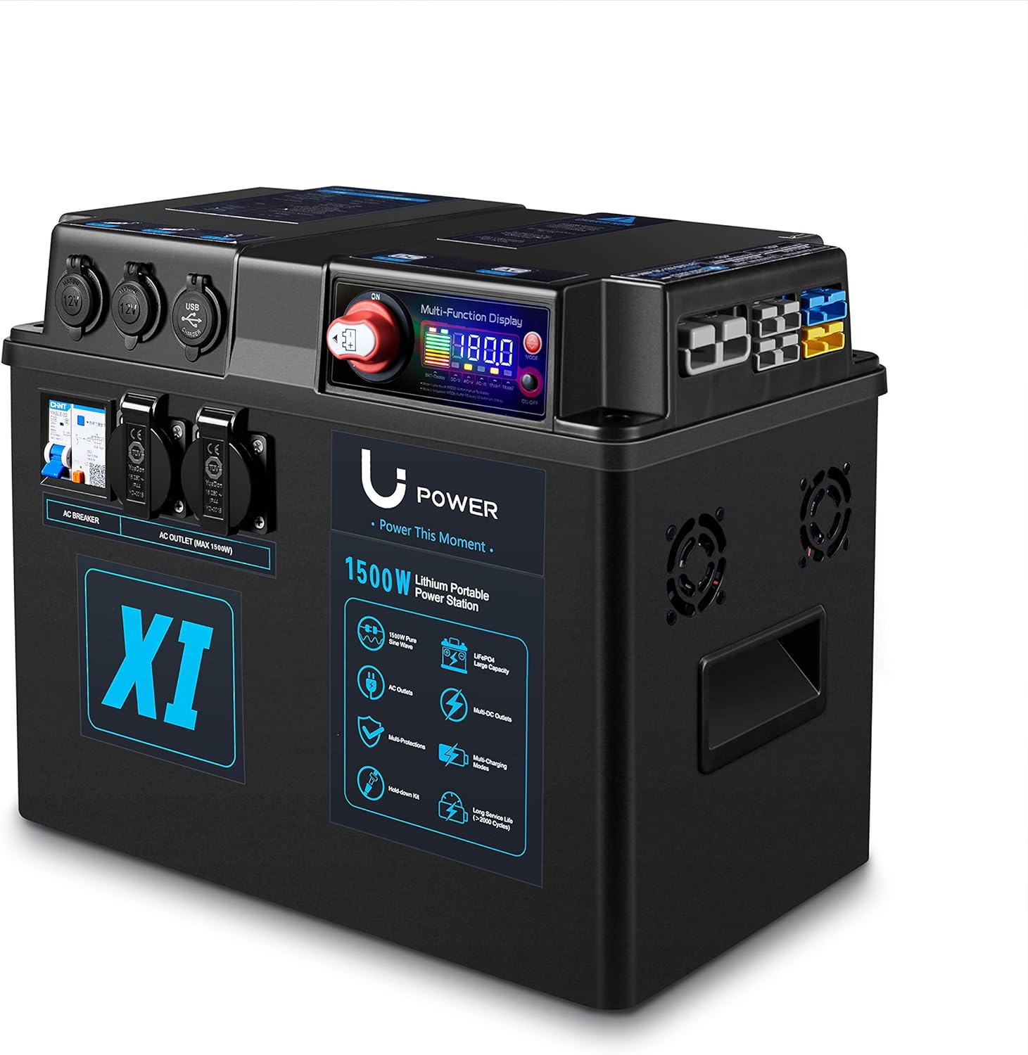

    Battery porn![​IMG]
    LINK (I don't benefit from sales of super sexy portable power stations)
    I'm researching battery power stations that provide the benefits of an auxiliary 12 volt, a jump pack, inverter, etc.
    Here's one at the lower end of the price spectrum: LINK The biggest downside of this one compared to the Dometic is that you can't charge it while it's in operation.

    The sexy 1500W power station above is nice at $2000, I guess, but it's L-ion and I'm looking for LifePO4 (more stable, 2000 cycles). I found another beauty which IS LifePO4, and it can be had at one site for $1300 with free shipping. On the manufacturers page it's available for $1640. This one has a 1000W pure sine wave inverter. We're getting closer....
