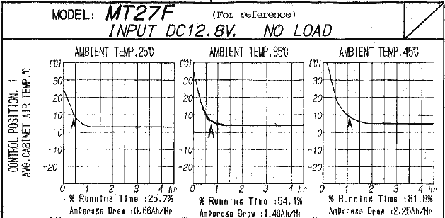

    Right, it's better if they publish something like this, as Engel does:
    One could play with the 61kWh/annum and make it look like 0.54 Ah/h at 12.8 volts, but I question it; too low. We can roughly compare the CFX3 35 and Engel figures above for around 90℉ ambient and 39℉ inside, but to get that much lower number for the CFX 28, I would have to guess they picked less challenging temperatures.

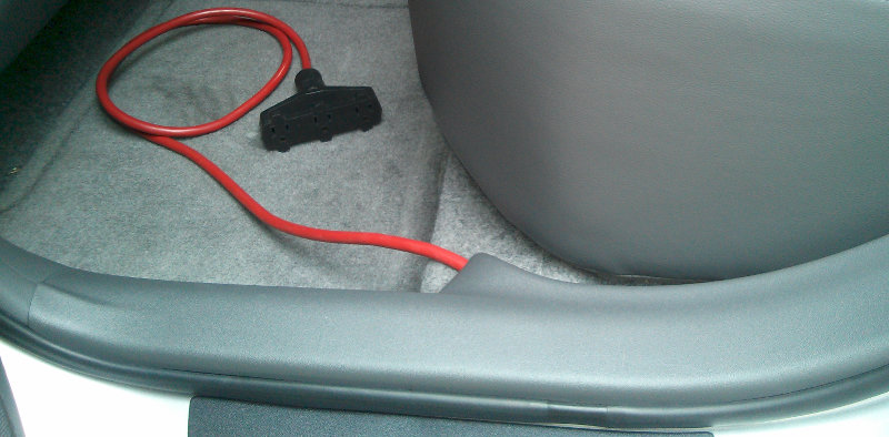

    Mine just sits on the spare tire, underneath the storage box, so it's completely out of the way. The spare tire angles forward a bit, so there's some clear height at the forward part. That space under there is better ventilated than the box itself; the cooling air for the traction battery passes under the box on its way to the exit vents hidden by the bumper cover. I didn't add any extra fans; there is one in the inverter itself that will start if it wants to. I have never had it complain about overheating. If it does, I can think about further measures then.
    For accessibility, I just used the end of a three-outlet extension cord, and ran the remote circuit up to the dash.
