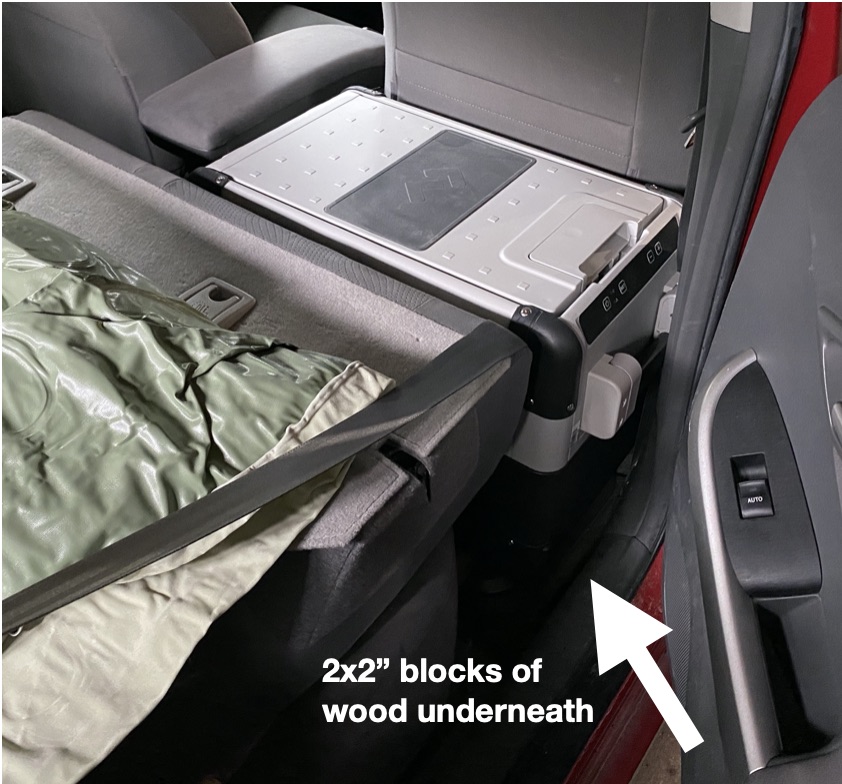

    You are correct. I learn new things here all the time. I'm thinking that the seat is not a very stable location. It will fit on the front seat tipped up a bit, in front of the front passenger seat, as well as in the rear box tipped up (on a 2x2) such that the hatch can close. I still wouldn't put it in one of these locations.
    Glovebox?
