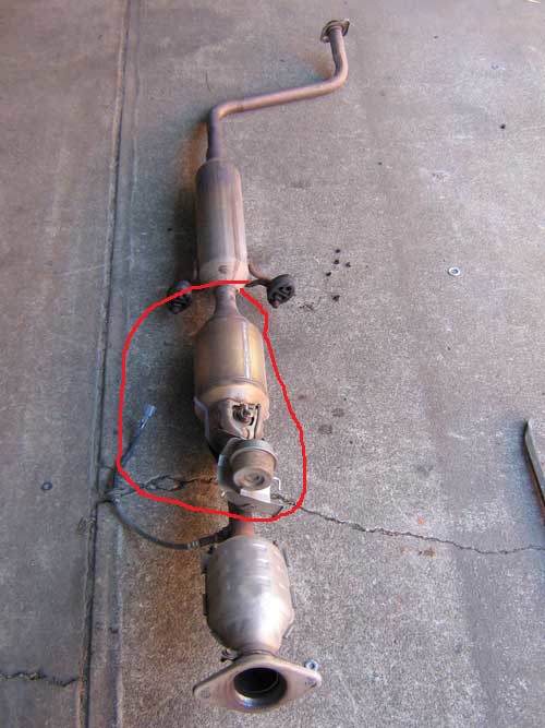

    Took it to muffler man, and they said the Second Catalytic Converter failed and was plugged. After doing HEAVY research on the internet, THERE IS NO AFTER MARKET PART! I am pissed. It is forcing me to buy the $1000 part! Looking at the Second Cat, there is a vacuum piece that attaches to what I believe opens the valve on the inside of the Cat.
    Question:
    Of course I know its probably not legal to do, so lets get passed that. Would my engine/car get damage if I removed the second catalytic converter and straight piped after the First Cat? I am on last resort... Anything helps!

    I have not looked at mine yet to see what your describing. Having said that, if their is no O2 sensor immediately before or after the cat it shouldn't be an issue

    Yes it is after the O2 sensor but there is a vacuum tube connected. I cannot find anywhere what that tube does... and if it is vital to the car.

    It is probably used to heat up the o2 sensor. I would cut the cat at the beginning of the thickest portion behind the vacuum motor. Then remove all the ceramic material and weld it bac together. Make a small cut at a 90 degree angle to the maincut before you finish the main cut so when you weld it back together it is aligned correctly.

    Looking at that vacuum motor I am almost certian it is used to heat up the o2 sensor quicker therefore putting the vehicle into "closed loop" quicker. So even if that vacuum motor doesn't work it still should go into "closed loop" it may just take longer.

    Catalytic converters that repeatedly die generally mean there is an engine condition that's killing them. Persistent misfiring or oil consumption will do it, by sending unburned HC straight back to the cat to burn it up from the inside. So the first thing I'd do at this point is look for what's up with the engine that's killing your cats. Fix that, and you'll probably get better performance/mileage too, cat or no cat. Have you pulled engine codes?
    Hmm, what do you mean by "anywhere" exactly? There's lots of information about it all over this forum and elsewhere on the web, not to mention at techinfo.toyota.com. A lot of sites give pretty good overall introductions to the technology in Prius - if you think you might keep the car a while, it's probably in your interest to look some of them up.

    You might be able to get away with unseizing the bypass valve. It is likely stuck closed. I have seen numerous threads on here about people doing just that. There are numerous ways of doing it but the common theme is to use a penetrating liquid like wd 40 and work the valve back and forth. Then you need to grease it with a heat resistant grease to keep it operating.
