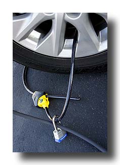

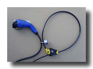

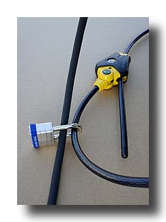

    Not sure why you are using a pad lock.
    You could just secure the charging cable close to the tire with the python lock.
