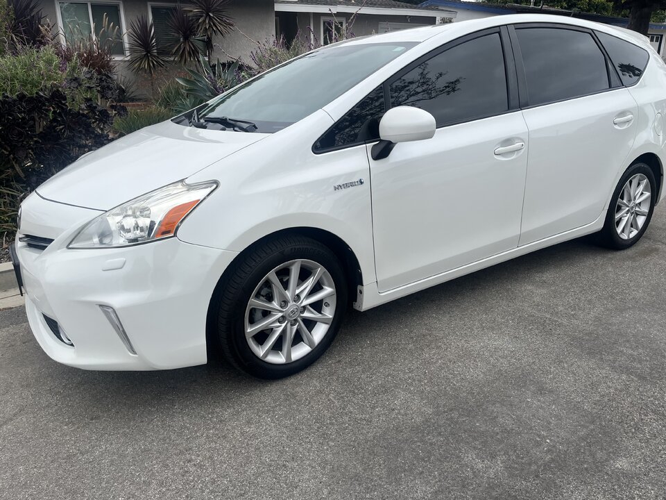

    Well, we finally bought our new-to-us Prius v.
    We wanted a 2015, 2016, or 2017 model, but we could not find one near us at a dealer that we felt we could trust to both prepare the car appropriately and to back up the vehicles they sell.
    We found a dealer that specializes in Toyota and Lexus hybrids, offers warranties on the vehicles they sell, repairs Toyota hybrids using repair technicians trained by Toyota in Japan. In fact, nearly the entire staff are native Japanese, who cater to a mostly Japanese clientele. Given that there are no Toyota Certified Prius v’s within 250 miles of us, this dealer/repair shop seemed like the best option.
    The only Prius’ they had on hand were 2010, 2011, and 2014. So we went with a 2014 Trim Five.
    Yes, it comes with an extended warranty for one year. All engine, transmission, and hybrid electrical are covered. It has a catalytic converter plate.
    We test drove it twice but only on city streets. It was very quiet inside —- even with the A/C running. I could barely hear the engine except when accelerating — and even then it was quieter than either of our other two cars. The ride was much smoother and more responsive than my friend’s 2016 Prius v, which felt sluggish on acceleration and rough on cornering. The A/C was cold.
    I hooked up an OBD2 reader and it found no codes. The NHTSA shows that all recalls for this model were applied.
    This dealer had a 2016 RAV4 hybrid but it was already sold. They have a Prius c (Trim One), but it lacks the cargo capacity that we want. We want to use our minivan less not only because its gets awful mpg, but also because its transmission is failing and the van now needs a new catalytic converter.

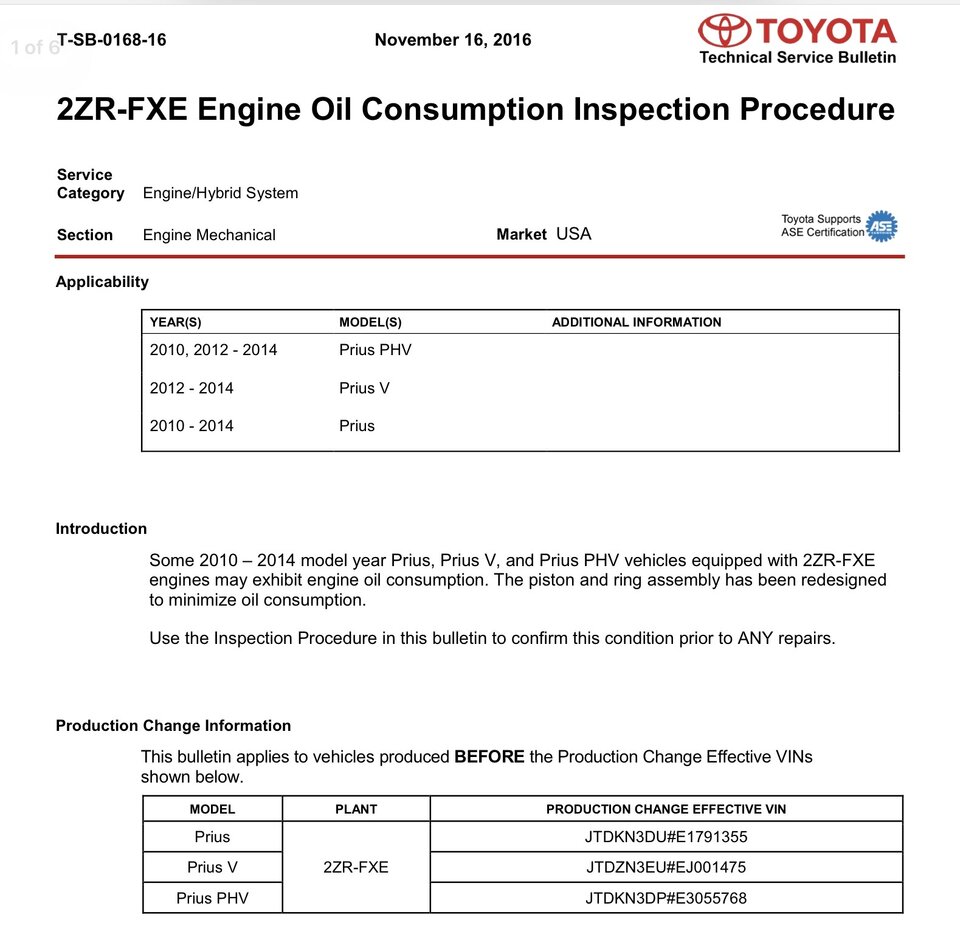

    According to the manufacturer plate on the driver’s door jamb, the vehicle was made in “5/14”
    Also last four digits of VIN are 5419. According to Toyota Technical Service Bulletin from November, 2016, Prius v’s that were made before number 1475 are subject to to a check for excessive oil consumption and may be candidates for new piston rings. See the attached pdf.
    But we will have to check the oil consumption for ourselves.
    I hope so.

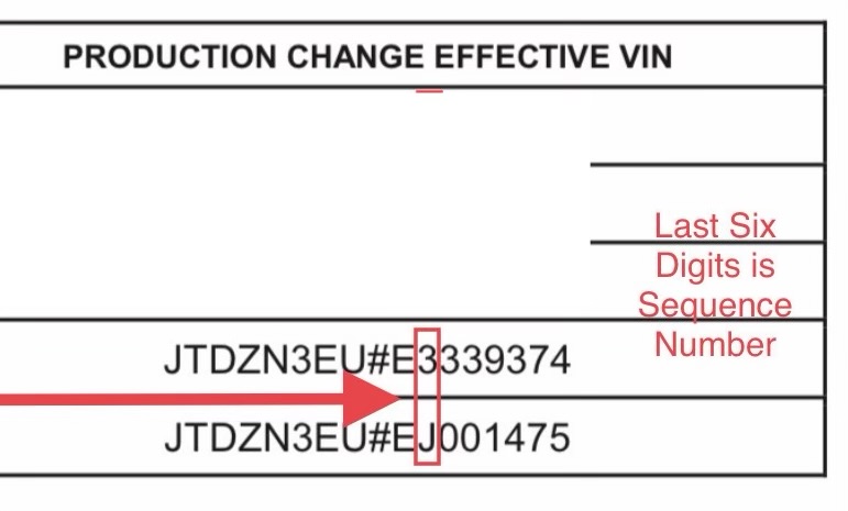

    That information is only half right. There were two plants and each used their own sequence numbers.
    Plants are 3 and J

    For our Prius, the plant letter is “J”.
