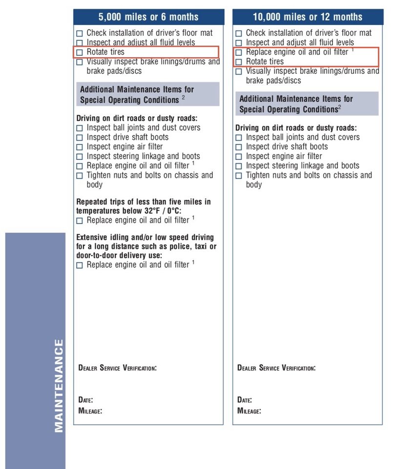

    We just received in the mail a windshield sticker that states that we need to return to the dealership for the next oil change at 182K miles. So it looks like the dealer wants us to do 5K oil changes. So, I will adhere to that schedule. I think for this next oil change, I will do it at the dealer. And, then start doing some on my own. I made a notebook to hold all receipts and maintenance paperwork, and it has sheets of paper to record maintenance notes.

    The Toyota maintenance schedule has a group of inspections and a tire rotation at 5k intervals.
    They will certainly do an oil change if you ask.

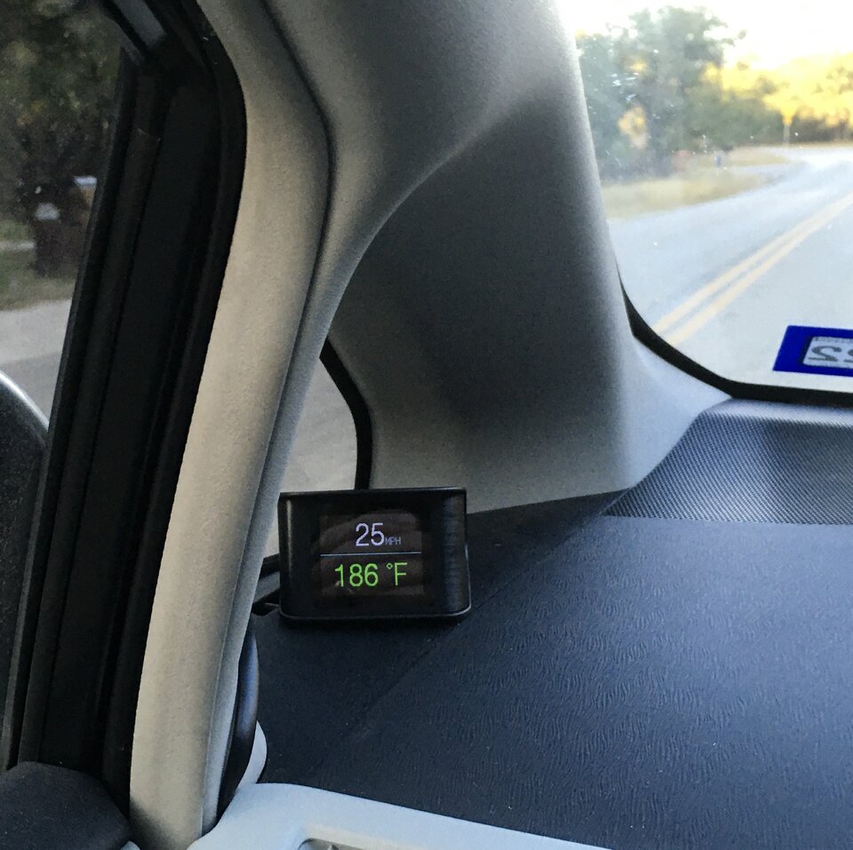

    Which is why I and others have an audible coolant temperature alarm set for 210f using a P10 with no history of network congestion. 248f is the vehicle alarm point and is a warning light only that often goes away quickly. Many with failed water pumps claim they never saw a warning.

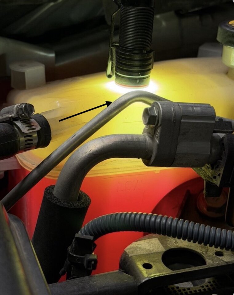

    If I had any sign of above normal coolant temperatures I would check the reservoir fill and coolant flow. Only once did the temperatures hit the 210f audible alarm, the reservoir cap was loose and was not allowing system pressurization.

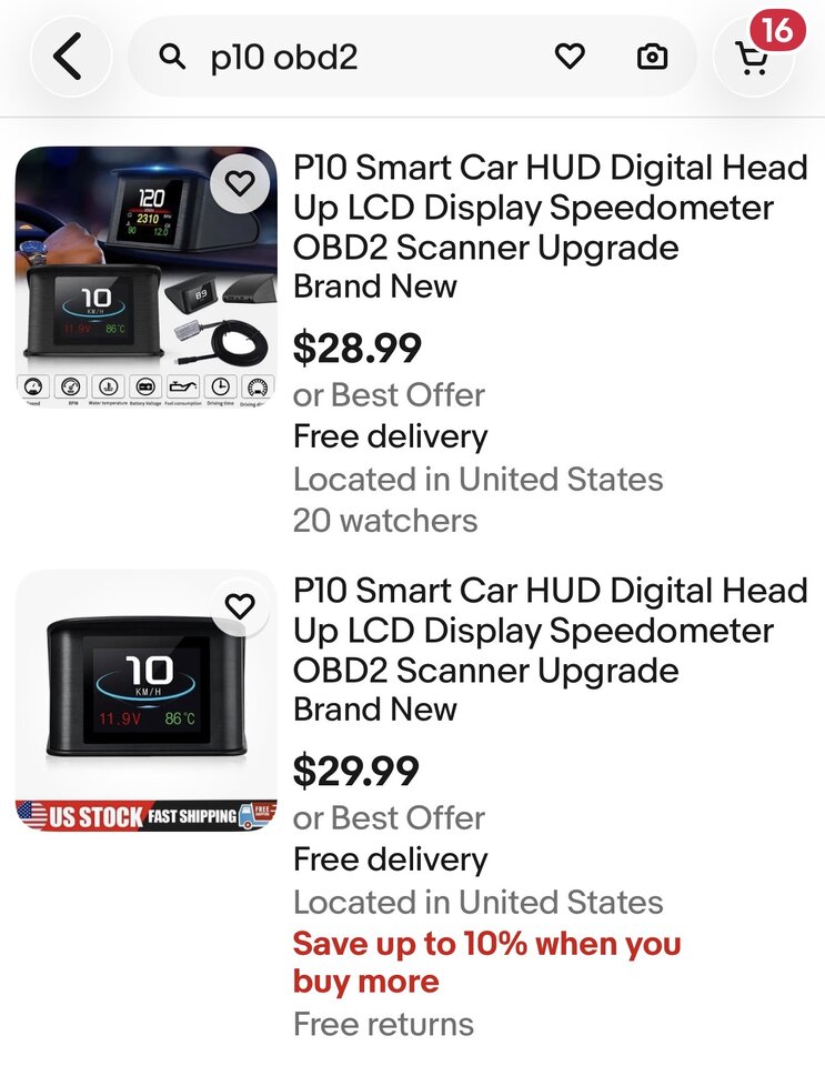

    I check the engine coolant level first thing in the morning and I always make sure the coolant filler cap is tightened and “clicks.” Ditto the checking the inverter coolant reservoir is at the right level and check that cap as well. So, far, no leaks and their fill levels are right near the “full” marks.
    So, how do I get a coolant temperature alarm like the one that you have? And how to connect it to the engine?

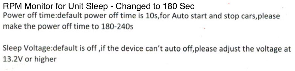

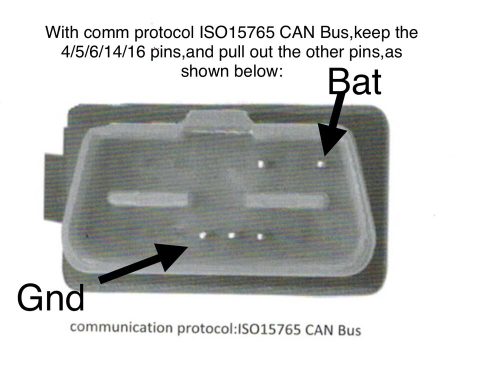

    It's not the easiest manual to follow and frequent oil and coolant changes are more important. Don't try to make it a general purpose scanner monitoring many points or expect it to be your trouble code display. Use the Kiss principle.
    Ebay sorted by price
    Decent video - Note that different display formats such as the easier to read two items can be saved. The data point displayed can be saved. Change Coolant Temp display from C to F in settings. Coolant temp alarm of 210f is 99C set in Settings.
    P10 Manual and Excerpts
