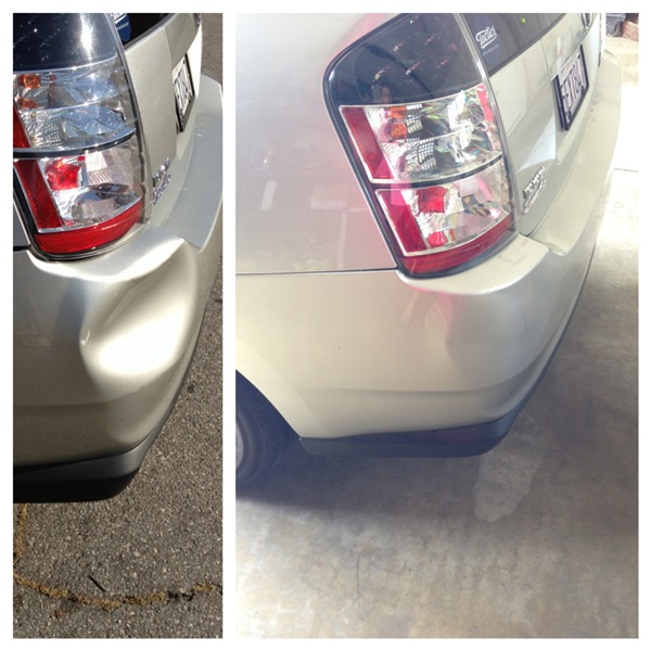

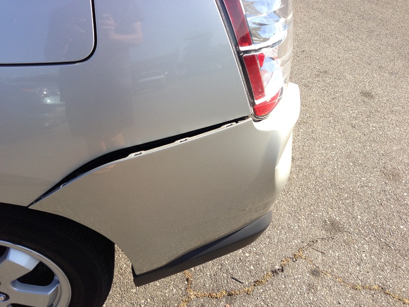

    I backed into someone and didn't get my car fixed by insurance (high deductible).
    All i did was unscrew the bumper from inside the trunk and the screw in the wheel well. Then I heated the dent with a hairdryer and popped it out from the other side! Super easy. Doesnt look perfect, but heck of a lot better than a few hundred bucks.

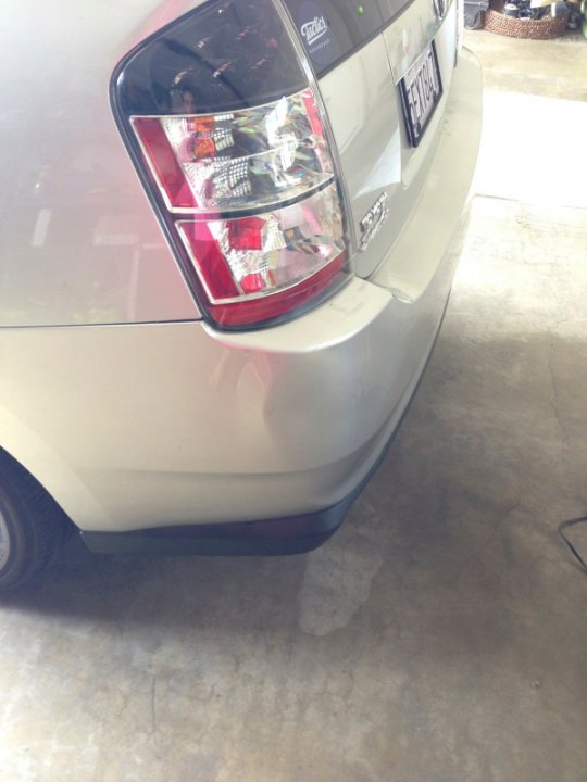

    Thanks! It's not perfect but you wouldnt necesarily notice unless you were looking for it, which is good.
    And heres a picture of it:)
