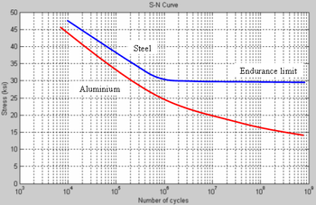

    Bolt strength charts known to Mr. Google suggest an aluminum bolt has about a third the tensile strength of a Grade 8.
    So we'd probably be looking at bolts bigger in diameter by at least a factor of √3. Those would be pretty fat.
    What I was given to understand about that was that it wasn't just about raw strength, but another important difference between steel and aluminum, that steel has an identifiable fatigue limit and aluminum does not.
    You can apply repeated cycling stresses to steel and as long as you've engineered them to be below where that graph goes horizontal, you can repeat them forever and it never gets closer to fatigue failure.
    Aluminum has no such property, apparently; every flexure ever put on it, however small, uses up some amount of its fatigue life, bringing the day closer when it fails.
    I also read somewhere that aluminum skins on aircraft are pretty religiously replaced after so many operating hours, for just that reason.
