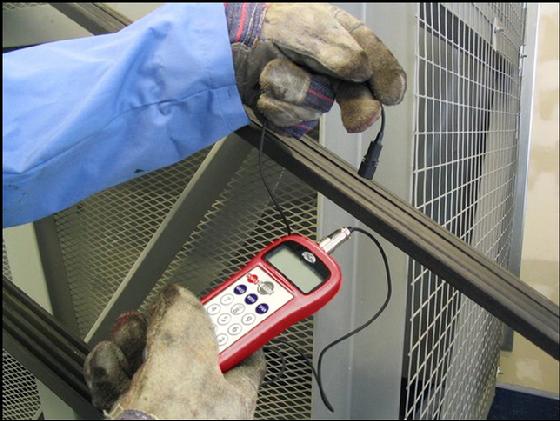

    I'm doing my serpentine this rainy weekend (Dec 2010) ... and always knew I'd resurect Patrick's helpfull guide here, when it finally became time for my own belt change. Time to change? Um, yea, how does 100K miles sound.
    :p
    Yep, I'm bad. But it took that long to finally see cracks. As for belt tension, I have a 5-100 lb tensionometer I'll be using ... . but for super-duper accuracy, they DO make another cool device. I give you the -
    Sonic tensionometer:
    To detect tension, a sonic type hears the vibrations when you strum the belt (just like you might strum a banjo string). The unit has to know what type/size belt it's dealing with in order to match it's frequency/tension. Very slick, AND expensive. That's why the cheaper style ... like mine ... basically a fish scale is way more popular.
