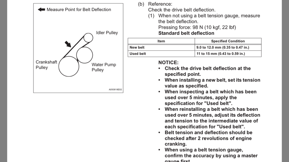

  10. Mendel Leisk
    61,482
    42,305
    Here’s the specifics, the deflection test option, seems fairly typical:
    xw20_driver, Brian1954 and BiomedO1 like this.

    It is interesting that the "used belt" criterion is applied after only 5 minutes of service. Suggests to me that the belt stretches almost immediately on use and then stabilizes. Also that it doesn't continue to stretch further (unless damaged somehow, for instance one of the rotating parts not rotating freely and applying significant drag).

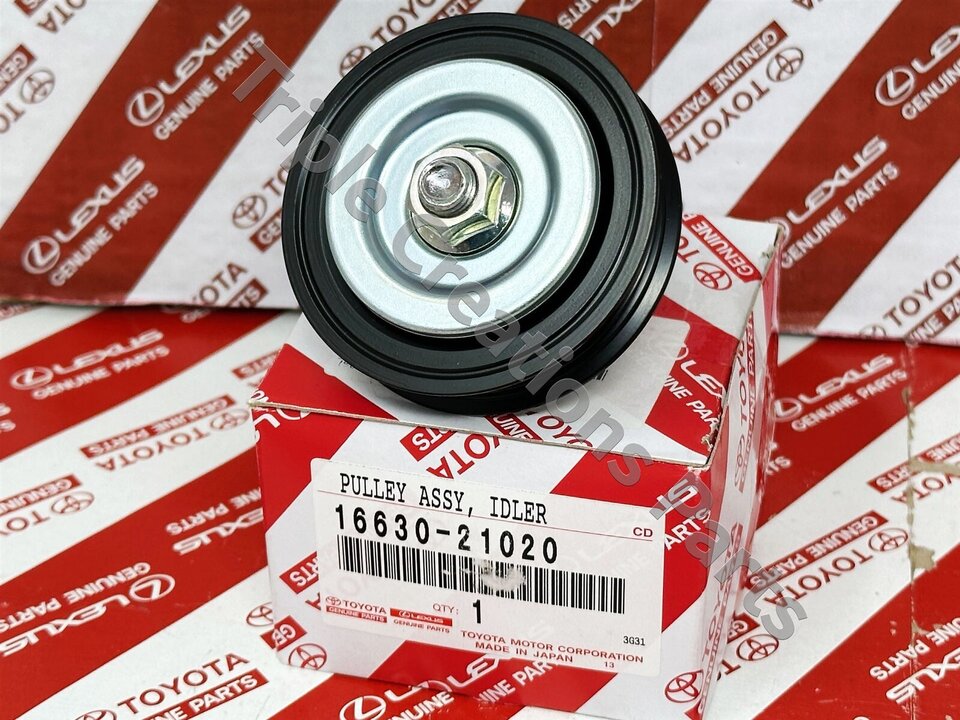

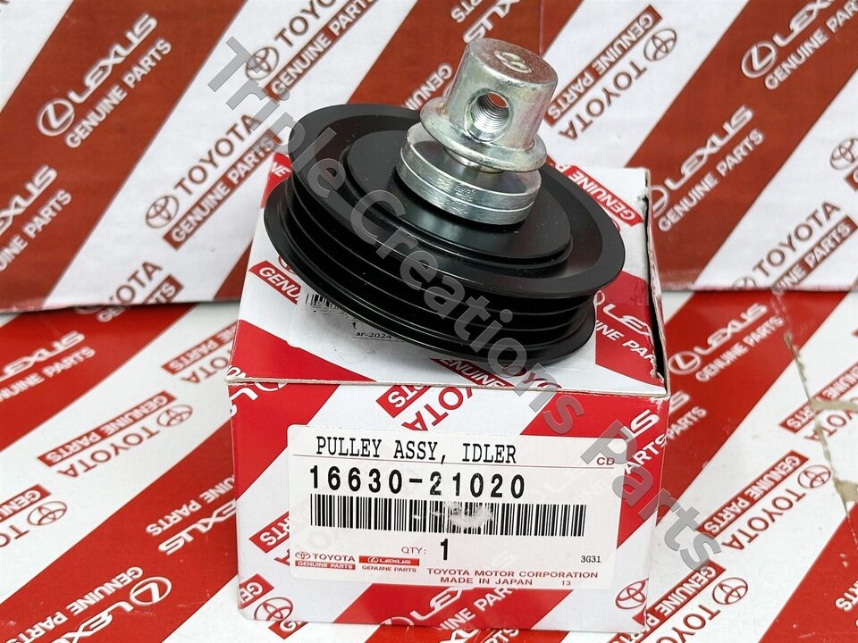

    The funny thing about this pulley, part number 1663021020, is that while it isn't a complicated device, it is really hard to find a decent picture of it. The Toyota parts sites just have a drawing.
    This site has a picture of one taken apart (assembly is an exercise for the user)
    16630-21020 Genuine Toyota Idler Pulley Assembly
    and here is the picture (in case the link breaks)
    These two are from an Ebay ad (not linking it since that link will inevitably break) and show it assembled. Except note the parts don't quite match! The part to the left of the nut on the site above has a smooth side, but on the Ebay part that looks instead like a stack of two washers.
    Anyway, from this it is pretty obvious that the tensioning bolt goes through threaded hole in the head of the odd bolt (so that it can pull the pulley up the groove and stretch the belt), the odd bolt goes through a slot in some piece of metal, and that the locking nut just tightens the flange on the head of the odd bolt and that part (which may or may not have a groove on its side) onto the metal on both sides of that slot (keeping the pulley from moving).
    Aftermarket replacements from RockAuto only have the bearing/pulley part. So best not to break any of those metal pieces!
