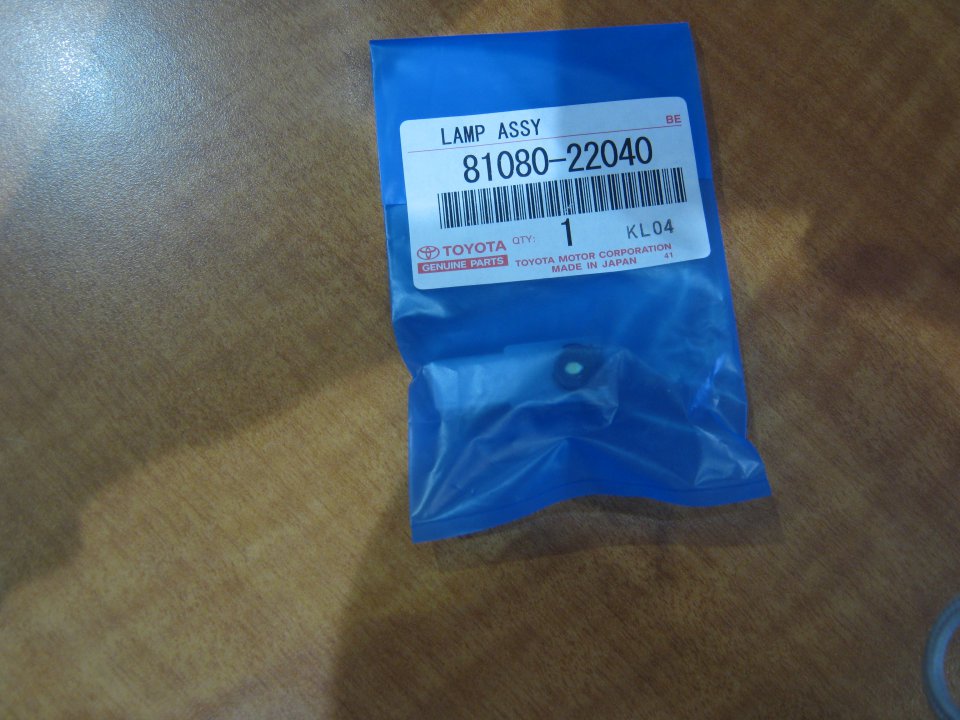

    Picked up a white LED replacement(Toyota part # 81080-22040) for the glove box...no time to replace it today...I had to take the gf shopping... :rolleyes:

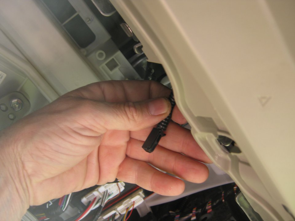

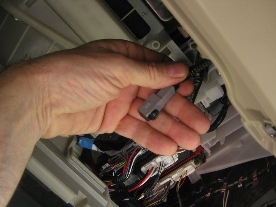

    Another "no tools required" (mis)adventure begins... ;)

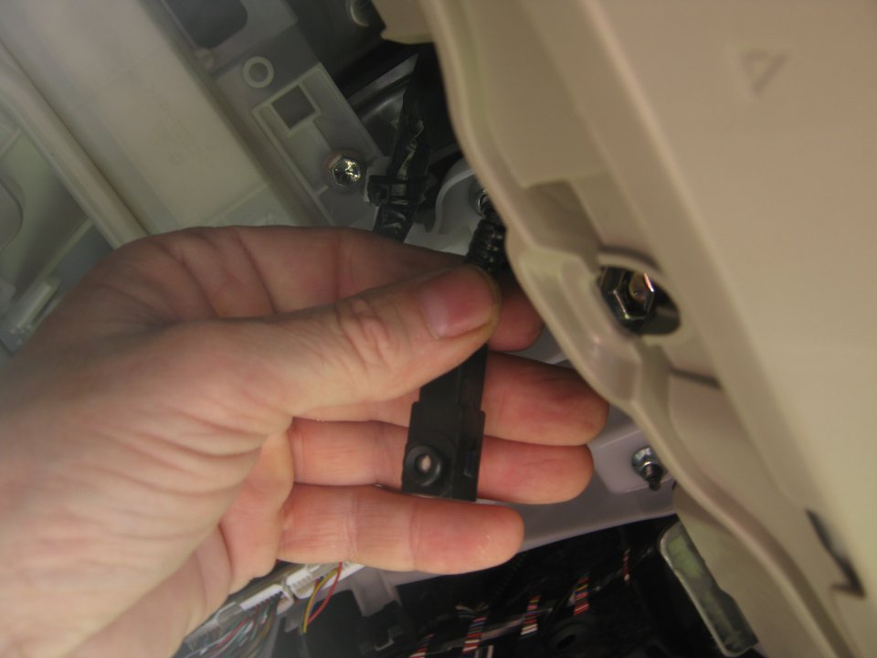

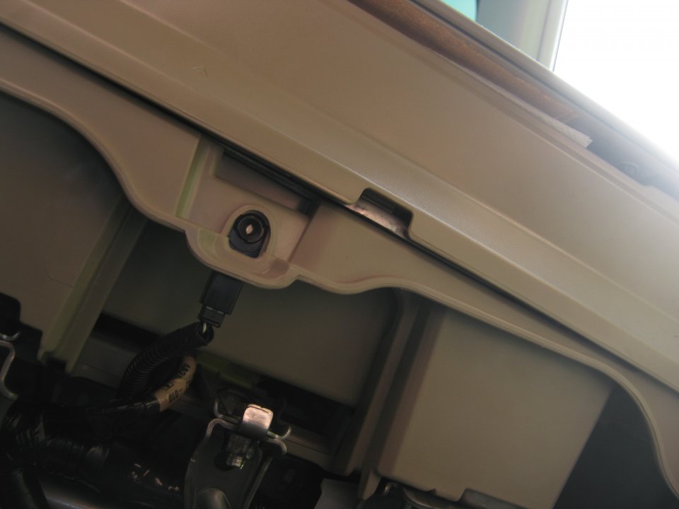

    Needing a little more useful light to finds anything in the glove box at night. I swapped the stock amber LED for an LED of the white variety... :cool:
    Glove box LED:
    You can find the glove box LED hiding above the lower glove box in the dash. To access the glove box LED, you will need to remove the lower glove box from the dash. Begin by emptying the lower glove box of its contents. There is a black ball joint, connected to a strut, attached to the right side of the glove box. This needs to be removed. A small amount of pressure will pop the strut from the glove box. Then apply pressure(squeezing) to the sides of the glove box to release the large pins from the dash. It takes a fair amount of pressure to release the first side. Once out, the other side will slip out of the dash with a slight angle. Remove the glove box and set aside.
    For images of the above steps, see post #171 of this thread. (y)
    Once the lower glove box is removed, you will find the glove box LED is mounted to the front edge of the dash. There are a pair of small clips on the sides of the LED housing that will need to be released to remove the LED. This is easily done with your fingers. A single wire harness connection also needs to be unclipped to remove the LED housing. Once removed, reverse the above steps to mount the new LED and glove box cover.

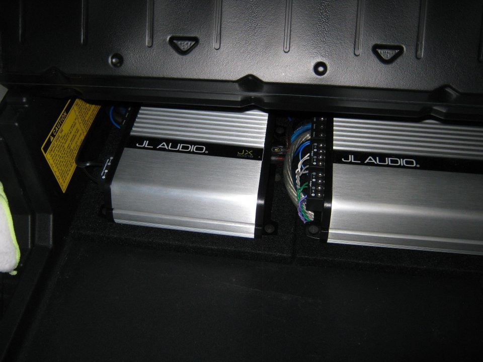

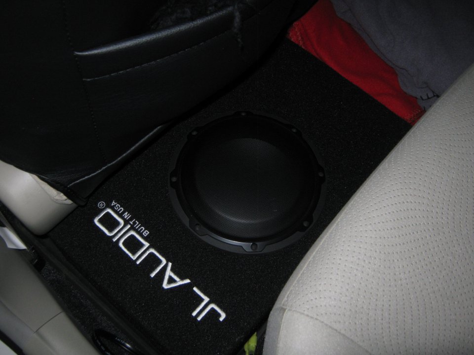

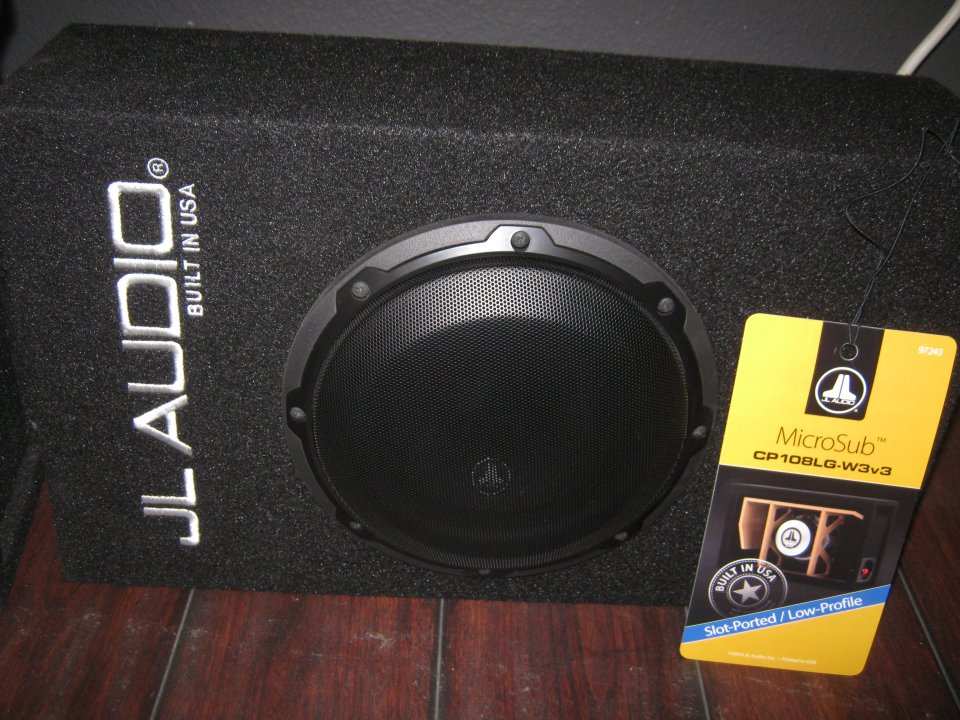

    The audio upgrade (mis)adventure continues... :eek:
    Through the magic of time lapse photography... :rolleyes: ...errrr. I mean, professional installation by the crew at All Pro Audio of Santa Clara.
    JL Audio JX500/1D amp:
    JL Audio CP108LG-W3v3 subwoofer:
    The subwoofer fits nicely, laid down flat behind the driver's seat...
    I had a quick disconnect for the subwoofer installed so I can move it to the rear cargo area, if I need the floor space for passengers... (y)

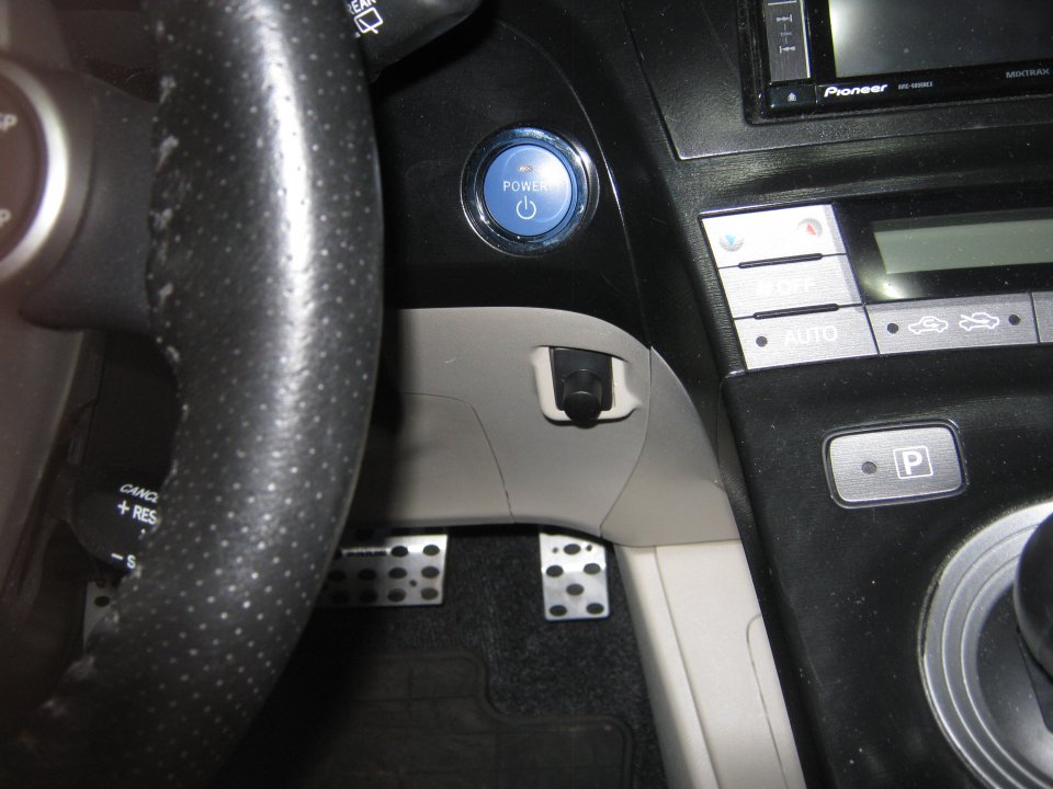

    Remote bass roll off knob:
    This combination of a 300w amp/8" ported subwoofer, adds a nice amount of depth and presence to the lower frequencies that has been lacking with the four 6.5" speakers I installed into the doors previously. Trying to achieve the bass response I prefer, in the 6.5" speakers, has resulted in a slightly muddied and distorted mid-bass that has been adequate, but not entirely accurate. With the addition of the amp/subwoofer combination, and now having the ability to adjust the high/low pass filters to specific frequencies, this allows each speaker to be more effective in its reproductive range. Taking away the lower frequencies(<100 Hz) from the 6.5" speakers, has also had a beneficial effect on the four channel amp, giving it more headroom, for a more dynamic, precise soundstage. Since I consider the Prius interior to be "acoustically challenged", I am still playing around with the low/high pass filter settings to find a nice balance.
    Current settings:
    High pass filters @ 100 Hz for the front and rear 6.5's
    Low pass filter @ 80 Hz for the subwoofer
    The addition of the bass roll off knob, in a switch blank below the start button, allows for quick and easy bass adjustments on the fly. Since all recordings have a different amounts of bass, mids and treble, this bass roll off allows quick adjustments without entering into the settings on the HU each time. If you are someone that uses the random playback function, this is a invaluable option to any audio system.
    Ruh roh... :censored:
    ...first comment from my gf after the install..."Is the music louder?" :eek:

  13. Blizzard_Persona
    Nov 2, 2014
    1,787
    948
    Pa.
    2023 Prius Prime
    XSE
    Am I looking at the pictures correctly? Is your sub on the rear floor where a passengers feet would go should someone be sitting there?
    Most setups I have seen have been in the trunk area..
  14. sfprankster
    sfprankster Active Member
    Sep 25, 2014
    444
    490
    Santa Cruz Mountains, CA
    That's correct.
    I have yet to have a third person in my car. 99.9% of the time, the rear seats are folded forward to carry cargo(canopy, tables, etc) for events.
    If I do need to make room for another person, there's a pair of quick connects to move the sub into the rear cargo area.

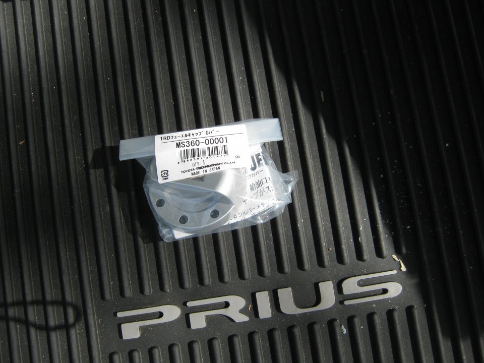

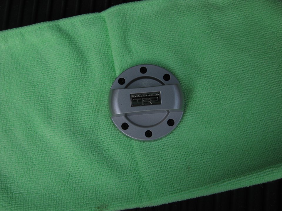

    I received a few packages from Japan over the last few days... ;)

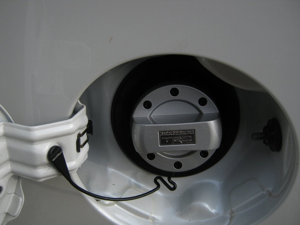

    Of the packages I received, the TRD gas cap cover is the easiest to install, so this is where I began... :cool:
    Another "no tools required" (mis)adventure...(y)
    TRD gas cap cover:
    After removing enough bubble wrap to cover a small piece of furniture... :eek:
    I found a TRD gas cap cover hidden inside... :cool:
    Front:
    Rear:
    Installation is straightforward and very simple... :whistle:
    Clean the gas cap with a microfiber tower and a little rubbing alcohol. Remove the pair of backing strips on the double sided tape and press firmly onto the gas cap. All finished!

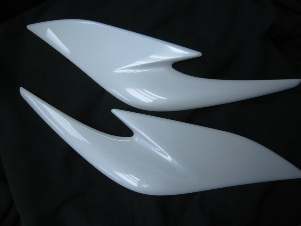

    A "not your soccer mom mobile" (mis)adventure... :eek:

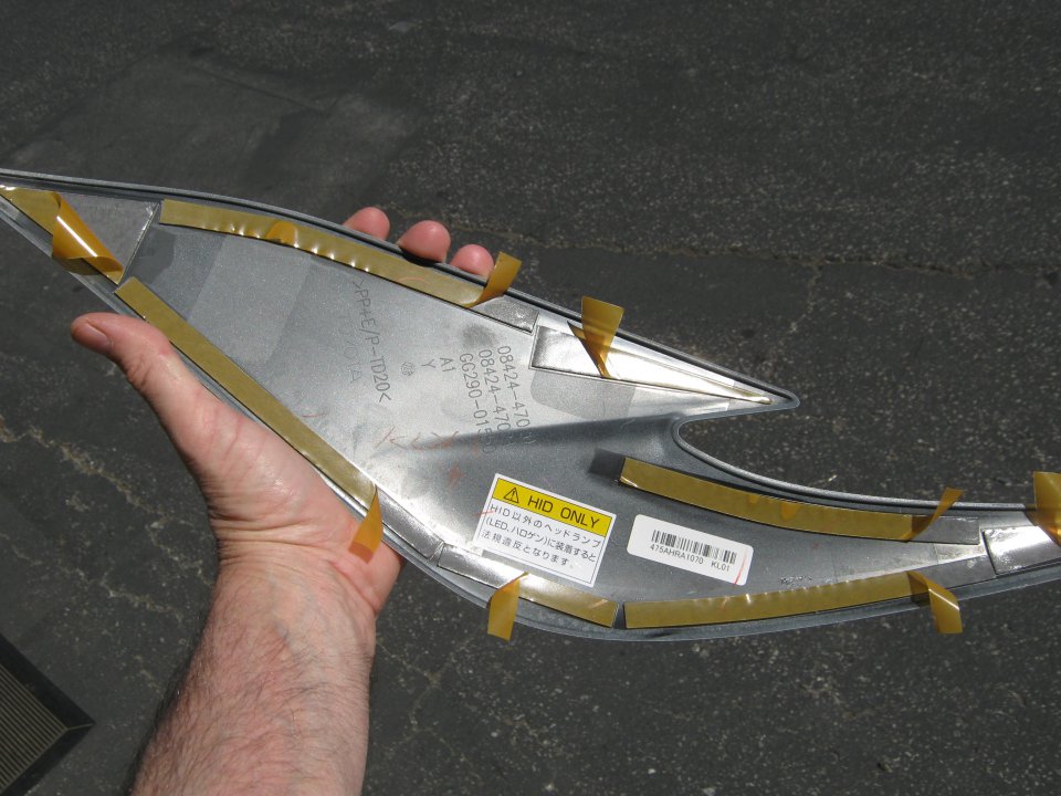

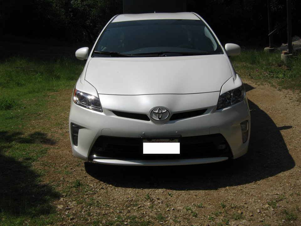

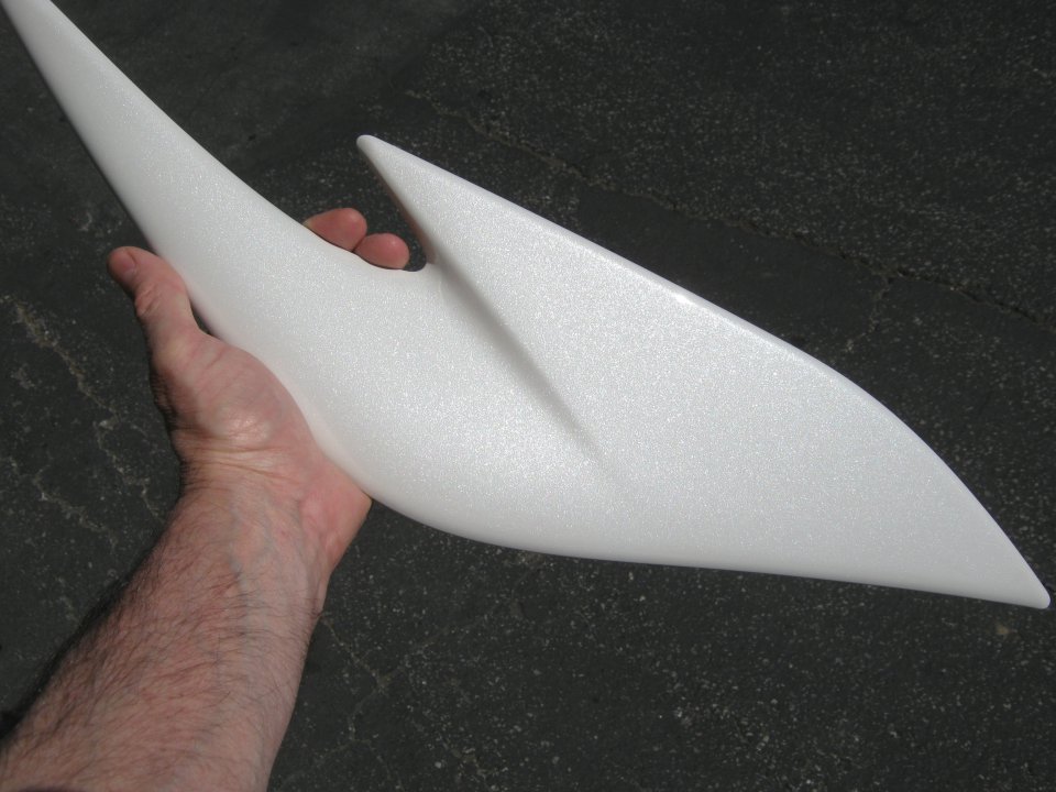

    JDM headlight eyebrow garnish:
    Begin the installation by checking the fit of the pieces onto each headlight. I found I needed to slightly modify the upper, inside edges of the garnish with a rotary tool/sanding drum, to fit the headlight contours cleaner, and to allow the double sided tape to have a larger contact area.
    Before applying the garnish, make sure to clean the area with a microfiber towel and alcohol. Allow to completely dry. As with everything involving double sided tape, I pull the backing far enough off to allow a small strip to lay beyond the edge of the garnish. This allows me to move the piece around and align it to where I want it located. Once in place, pull the backing strips and apply pressure on all edges. This mod is best, when the temperature is 70+. If it is colder, you can always warm up the area with a hair dryer.
    I applied a quick polish and wax, after I installed the eyebrow garnish, using Meguiars 205 Mirror Glaze and Gold Class carnauba wax.
    Somewhat of a contradiction to the common perception of a Prius being a soccer mom mobile(in my opinion), with the new aggressive style .
    :rolleyes: Like taking a trip to the salon to have permanent eyebrows tattooed on... :rolleyes:
