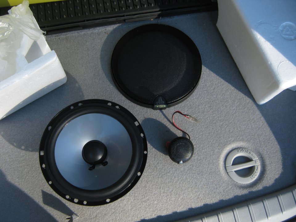

    This (mis)adventure begins on Dec 26, when my order of a pair of JL Audio TR650-CSi 6-1/2" Evolution TR Series 2-way Component Speakers arrived. Initially, I intended to install them as front speakers and install a pair of JL Audio 6 1/2" coaxials into the rear doors. But things changed as I contemplated the system and did some additional research on several variations of my original idea.

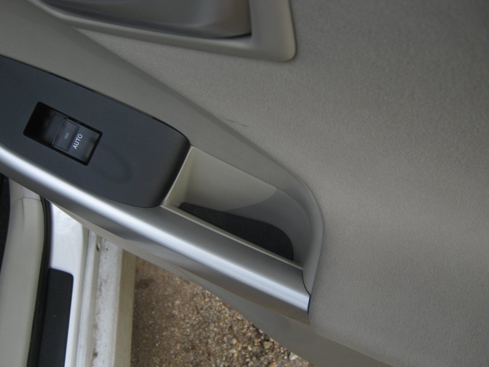

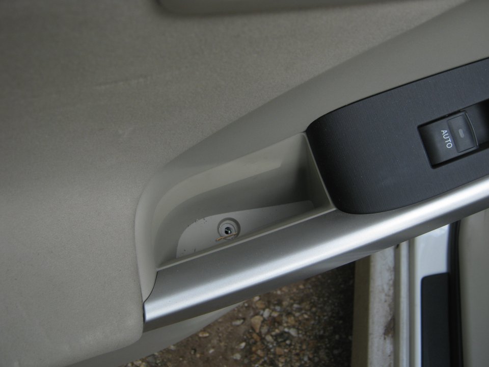

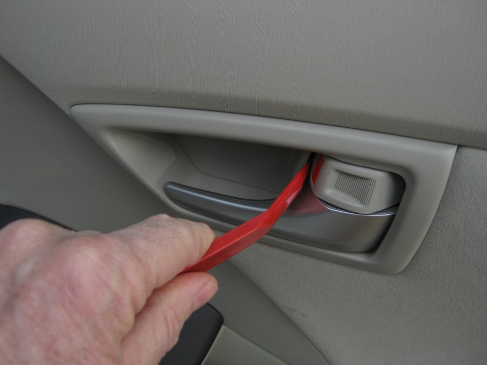

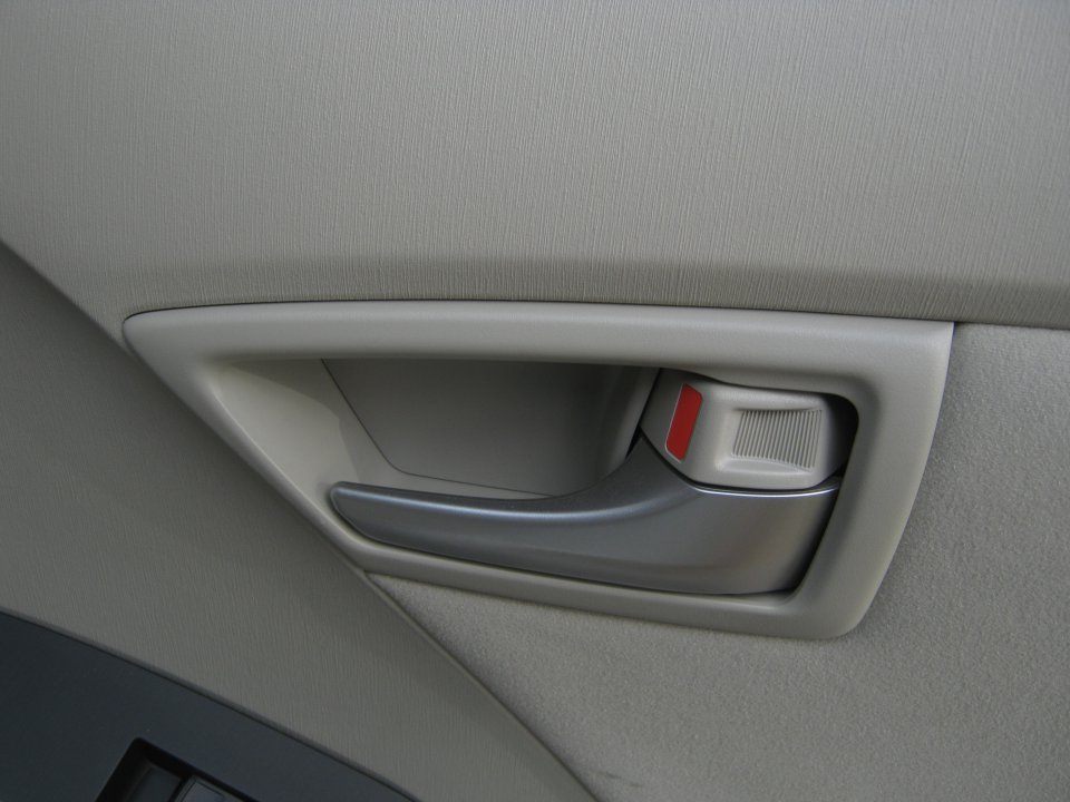

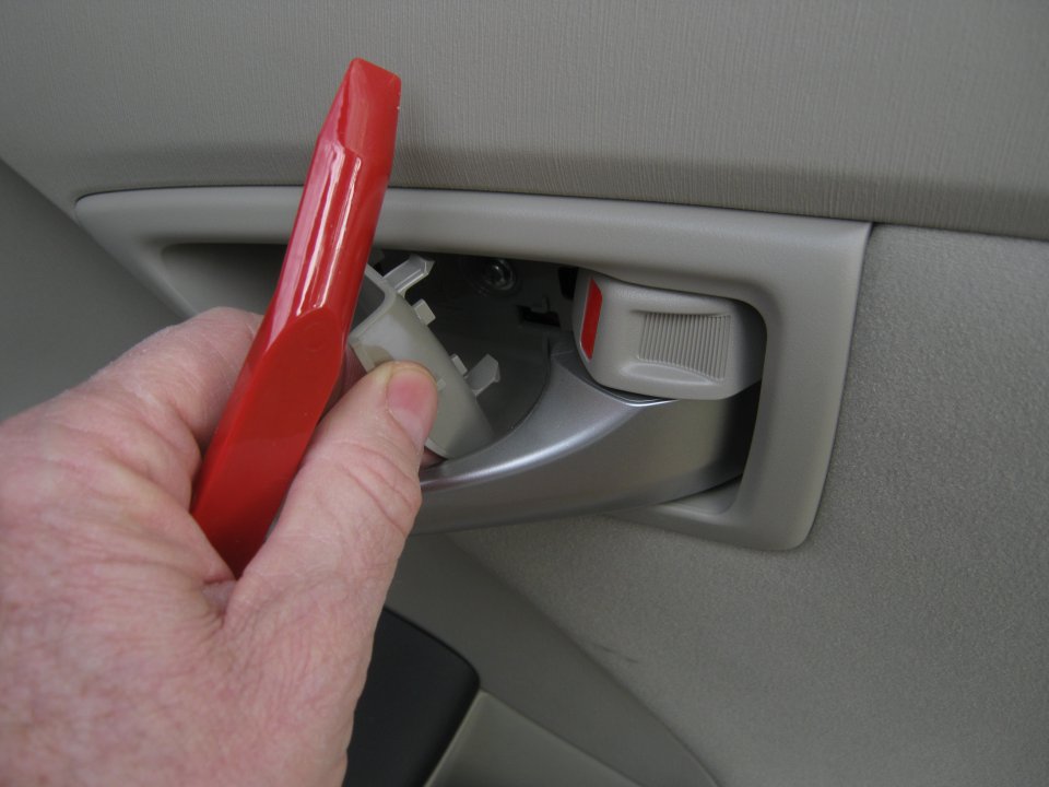

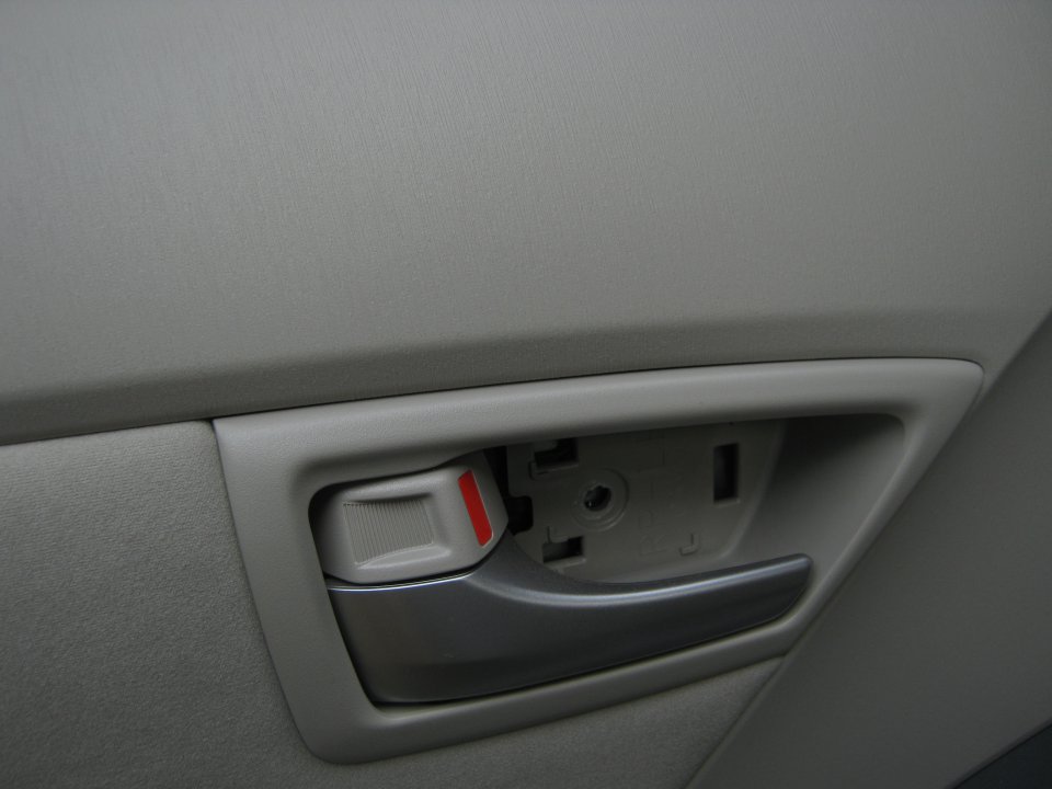

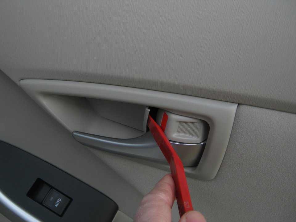

    Door Panel Removal:

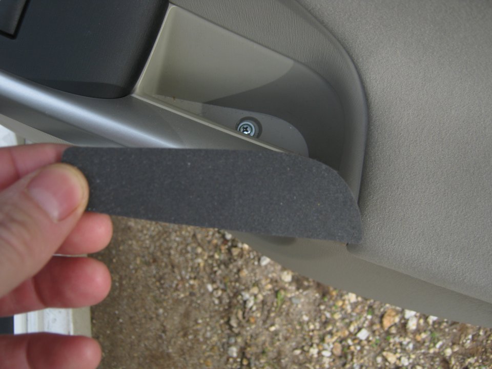

    To begin, you must remove the rear door panels to access the speakers and the area to be sound dampened. Locate a pair of screws, the first below a small rubber pad in the finger area behind the window switch. The second, behind a small plastic insert behind the door latch. I used a plastic panel removal tool to access the screws.

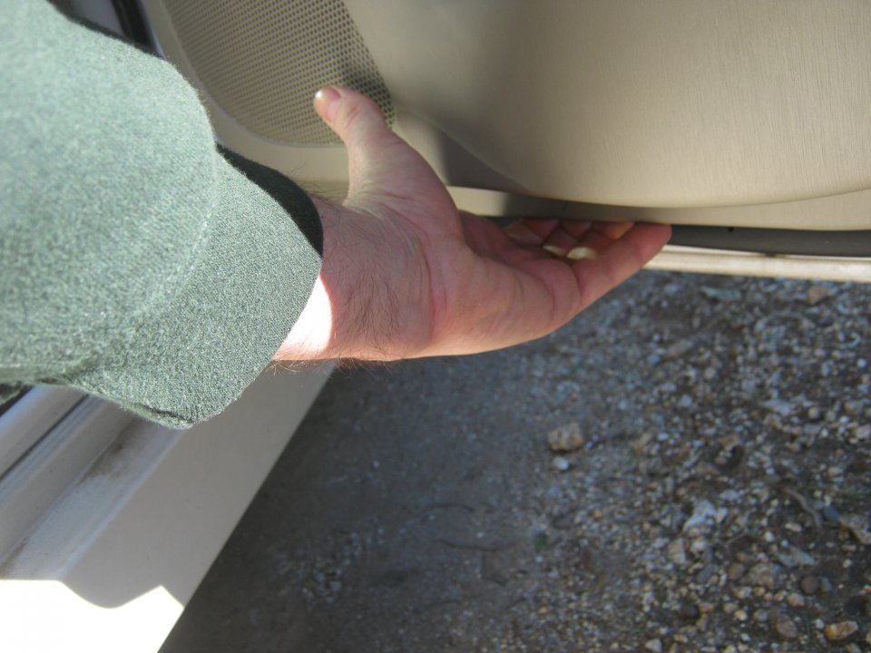

    Reach to the bottom of the rear door panel and you will find a hole running along the edge, large enough to insert several fingers. Give this portion of the panel a firm tug, to release the lower three plugs holding the panel in place. Then work your way up the sides of the panel to release the remaining plugs. The top of the panel is held in place by overlapping into the window frame. There is a single plug to be removed, with a small pressure release, and the door lock/release cables before you can remove the door panel and expose the area I chose to sound dampen.

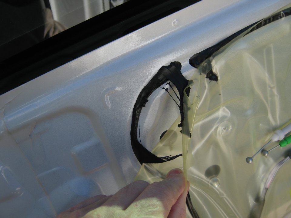

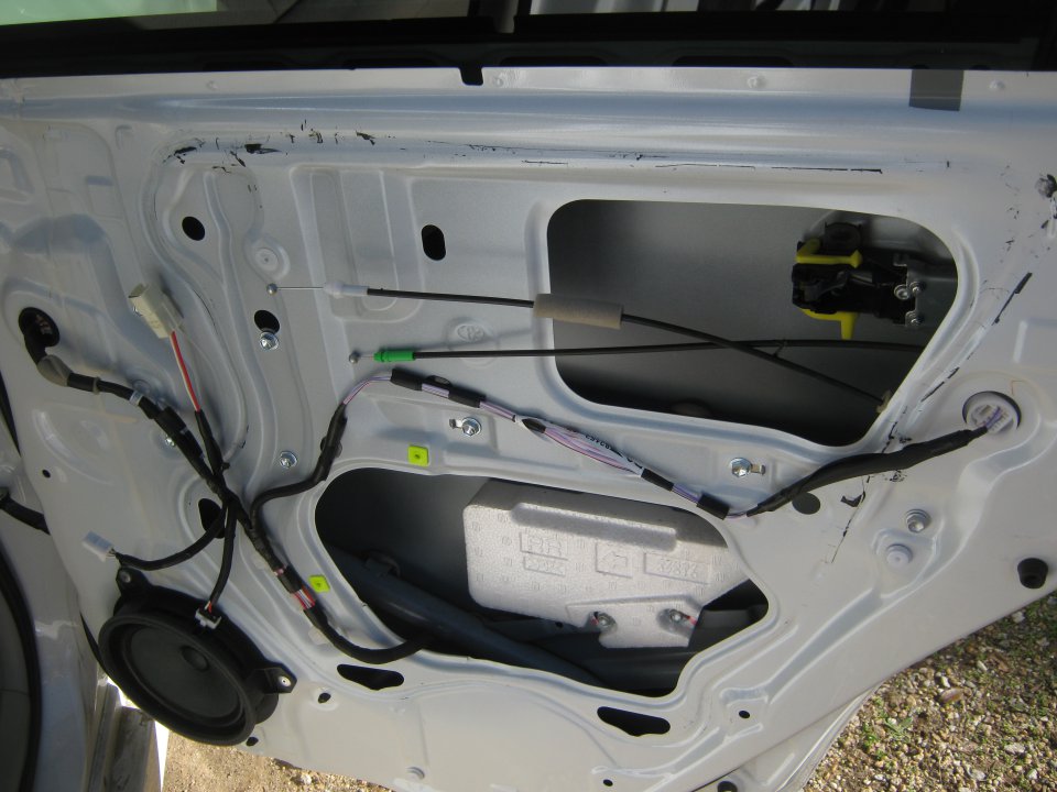

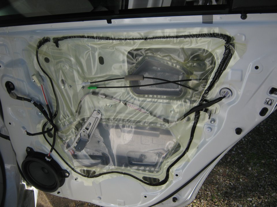

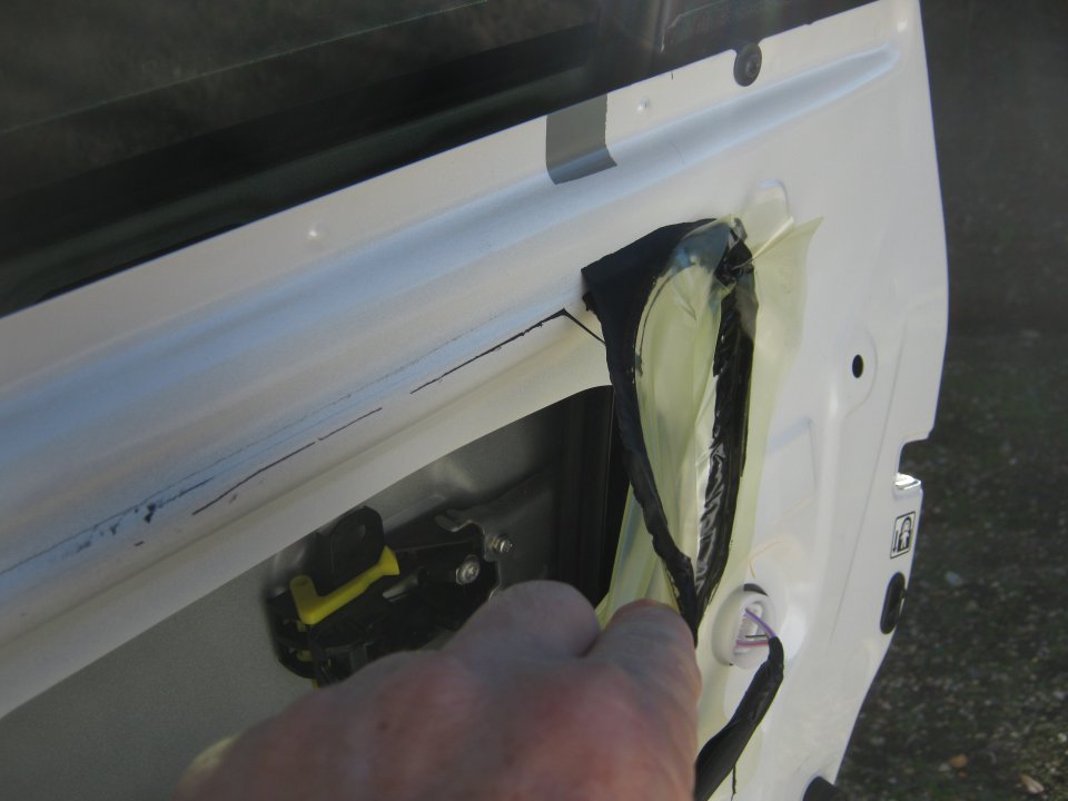

    Since I intended to place sound dampening material over the entire surface, I removed the stock moisture barrier. The black sticky material used by Toyota, will adhere to your skin and anything else you touch afterwards, so be careful. It removes very easily with a simple upwards pulling motion from one end to the other. You have to make a few cuts on the moisture barrier material, to clear a few wire bundles and the door latch cables.

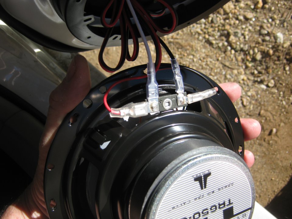

    Rear Speaker Installation:

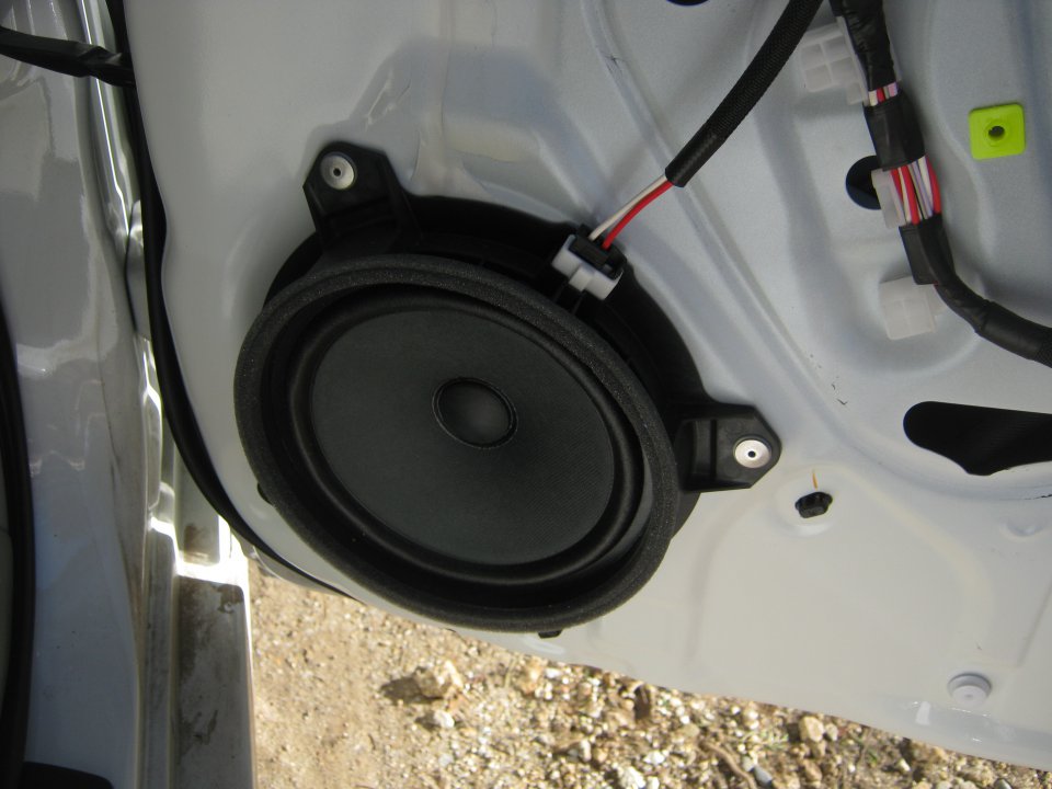

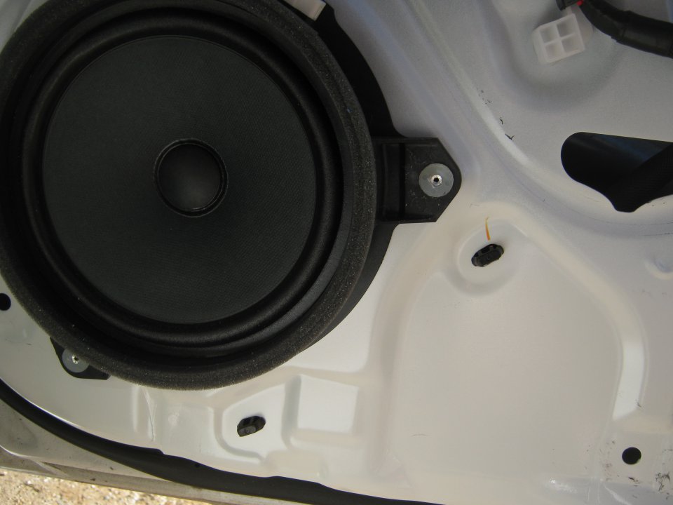

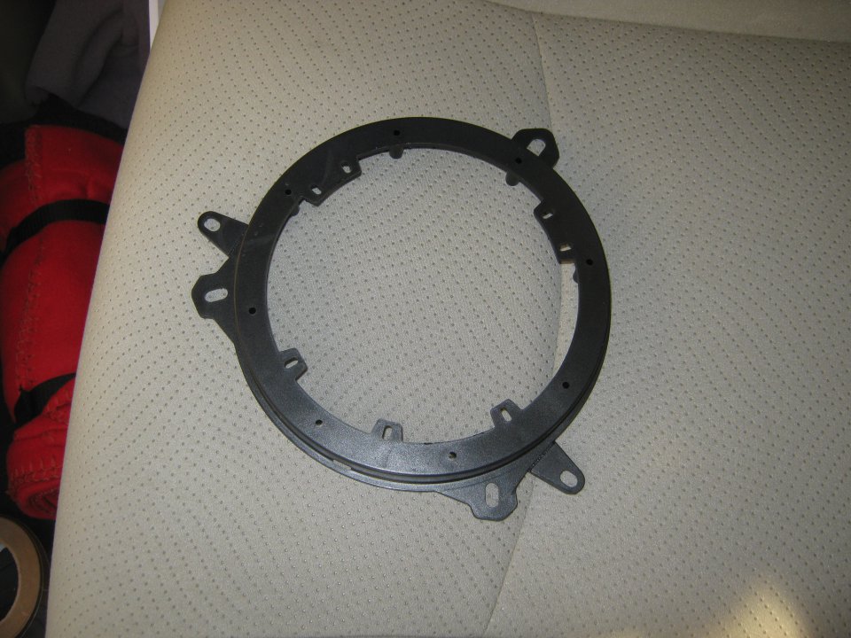

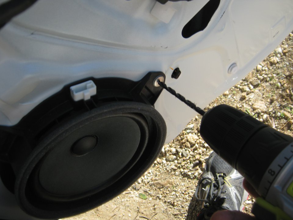

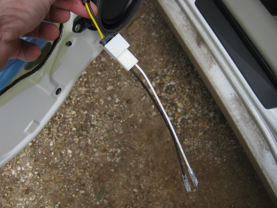

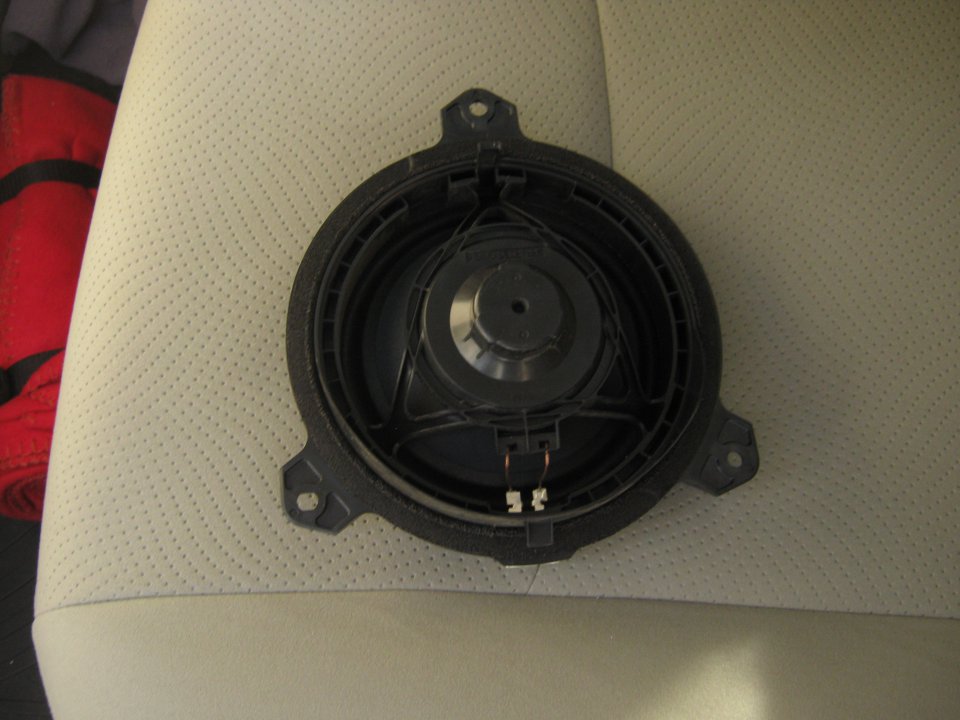

    At this point, it is best to replace the rear speakers. Unplug the speaker connection, by squeezing the release pin and place the connector out of the way. To remove the speaker, I drilled the rivets holding the rear speaker bracket onto the door with a 3/16" drill bit. If you are attempting to reuse the factory bracket, I would take my time drilling the rivets. Going to quickly, will cause the rivet to spin in the bracket, generating heat and melting the speaker bracket tabs.

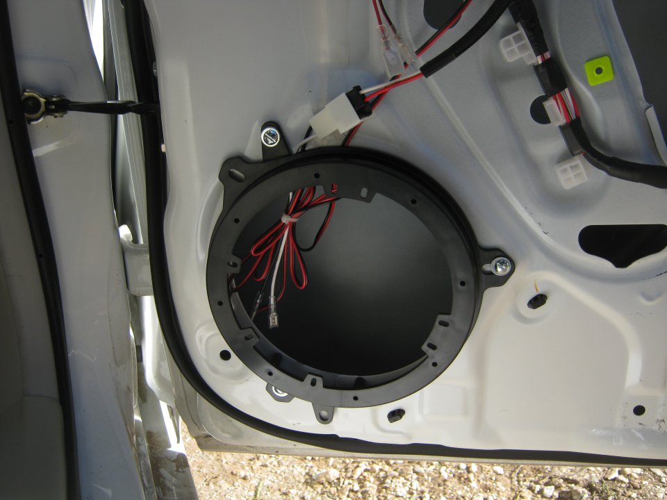

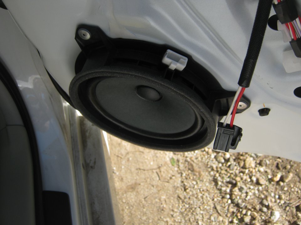

    I replaced the factory brackets with Metra 82-8148 6"-6.75" Speaker Adapter for 1998-up Lexus Scion Toyota using the supplied screws, washers and nuts. I tested the windows to make sure I had plenty of clearance and didn't have to cut the screws shorter. I also used a Metra 72-8104 SHGM01B Speaker Wire Harness Adapter Plug Toyota to make an easy and clean connection, as I plan to remove the speakers/audio system when I sell my Prius. There is a small indentation in the door frame, near the top of the speaker, where I ran the speaker wires into the door for the connection to the speakers. Make sure you have a solid connections for all of the speakers.

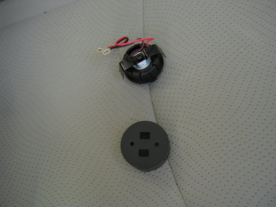

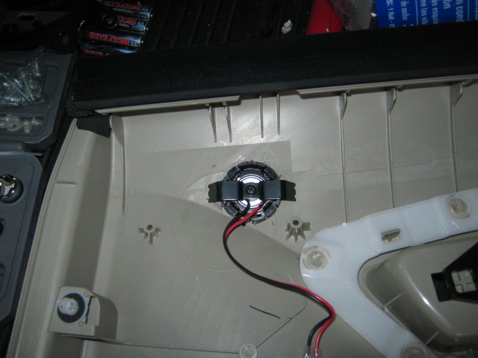

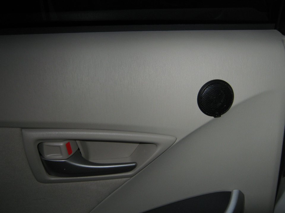

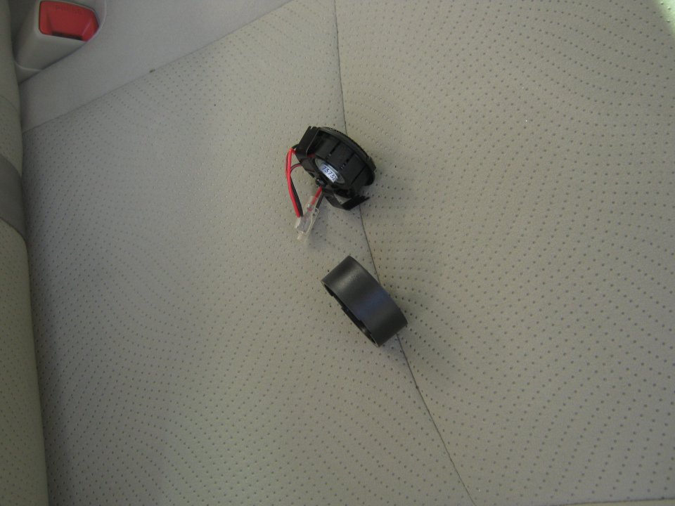

    Having the option to either flush or surface mount the tweeters, gives this speaker system a latitude in mounting locations.
    I chose to flush mount the tweeters near the upper front of the rear door panels. I began by drawing a template of the tweeter on the inside of the door panel with a felt marker. Then drilling several small holes around the inside of my template. I used a VERY sharp, fine tipped hobby knife to make small adjustments to the hole to create a pressed fit for the tweeters, along with a supplied bracket, to hold them in place.
    ....and the fun continues... :whistle:

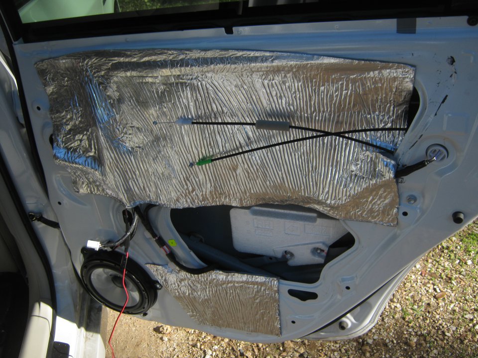

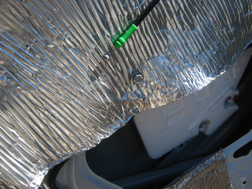

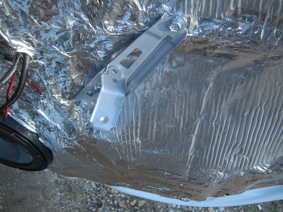

    Sound Dampening the Rear Doors:

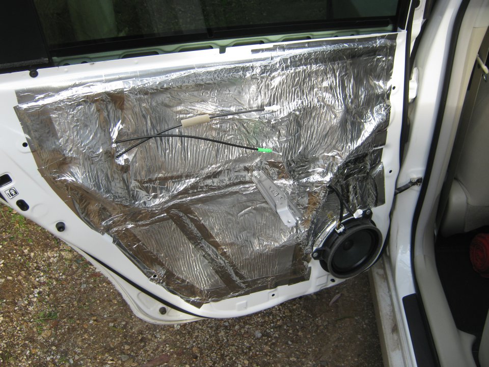

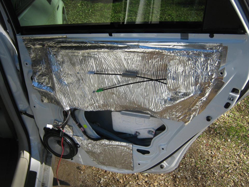

    Sound dampening the rear doors...or how to make your Prius sound like a Mercedes Benz when closing the doors.

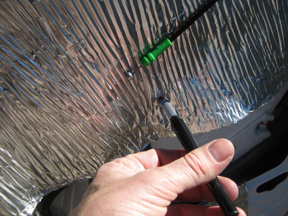

    I didn't want to spend the money to use products such as Dynamat as I have in the past. For this project, I used an aluminum backed foam, available at Home Depot or Lowes called Frost King Foam/Foil Duct Insulation, along with a high quality 2" aluminum tape to seal the edges. Clean the inside of the door frame using denatured alcohol and a microfiber towel. Like doing a puzzle, work your way around the door, covering in sections, with a 1" overlap in the pieces, until the entire door is covered. Press the material firmly against the door frame by hand, or using a roller to create a good bond. Leave a little room for the door cables and plugs to be able to move freely. Also, don't forget to mark the screw holes for the mounting plate for the interior door panel. Huge pain in the *** to remove all your work to find a couple of small holes. :eek: Once you have the door surface covered, replace the panel mounting bracket, plug in the window switch plug and the door lock/release cables. Lastly, place the interior door panel over the window frame and give each plug a firm push with your hand. All that is left is to replace the two screws and the small panels blocking their view.
    IMG_5150.JPG IMG_5152.JPG IMG_5157.JPG IMG_5159.JPG IMG_5065.JPG IMG_5165.JPG
    ...and don't forget, you are now only half way finished with the rear doors. o_O
    Now rinse and repeat for the other side. :p

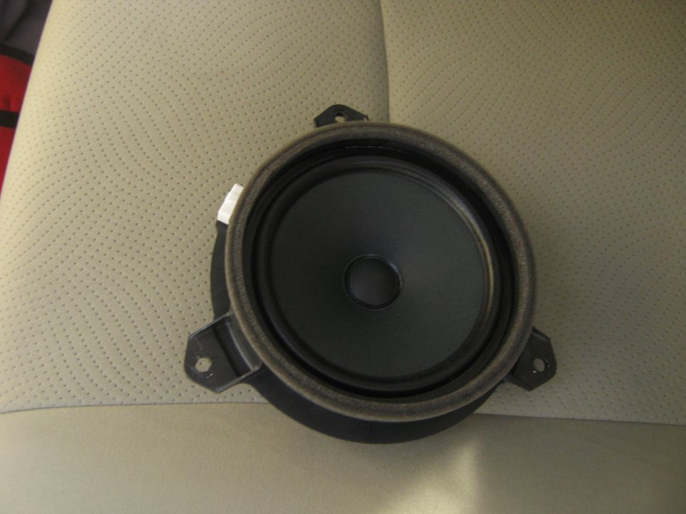

    The only visible piece of the Audio Upgrade Stage I, are a pair of JL Audio tweeters in the rear doors... (y)
    This is the no expense spared speaker Toyota uses in the rear of the Prius... :cautious:
