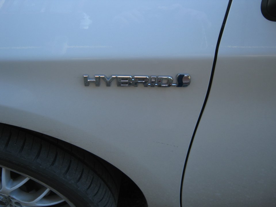

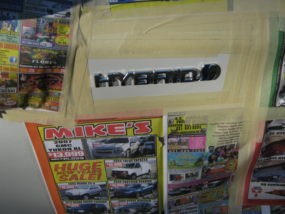

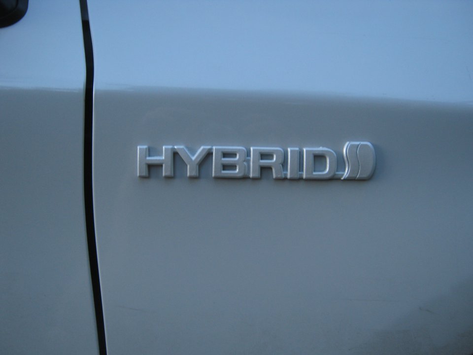

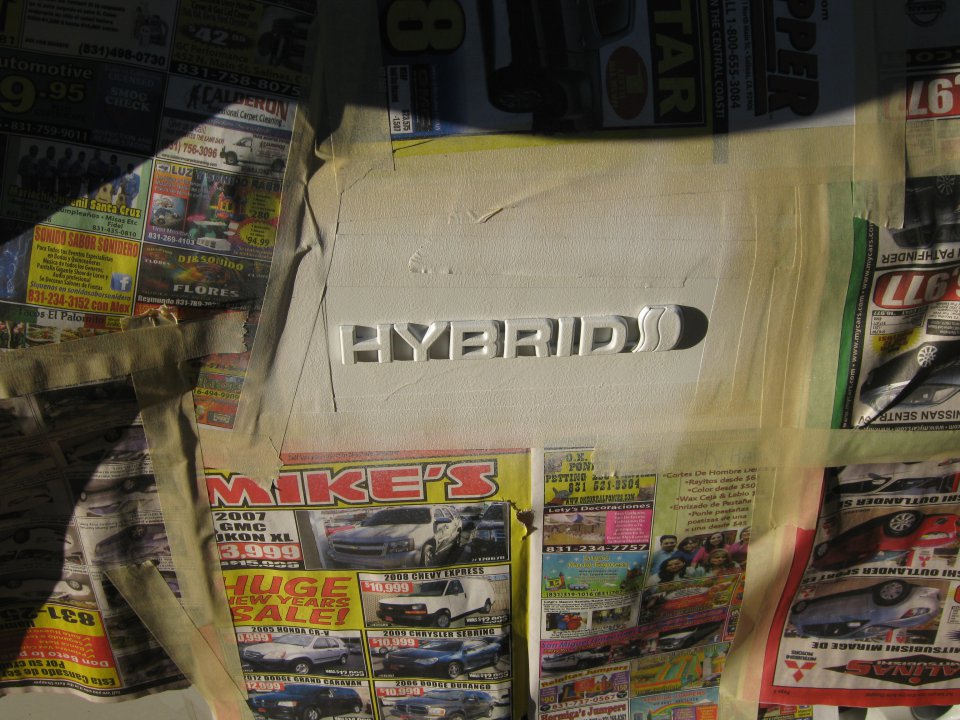

    Hybrid Side Badges:
    All began by cleaning the badges with a 50/50 mix of alcohol and water, using a microfiber towel and a few cotton swabs. A quick masking of the area, to limit the overspray, and I was ready to go... :)
    I sprayed the PlastiDip white a total of six thin coats and the pearlizer a total of two wet coats. I made sure to change the spray direction(front to to rear, rear to front) with each new coat to get full coverage on all sides of the Hybrid badges. I used a couple of toothpicks to clean up some of the tighter areas, that didn't release while doing the initial peel. Any overspray is easily wiped off with a microfiber towel.
    This mod gives the side hybrid badges a slightly subdued look against the Blizzard Pearl, and for me, it's much less obnoxious than the chrome. As an added bonus, it also matches the front and rear Toyota badges I PlastiDipped a while back.

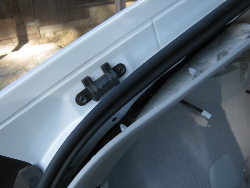

    Another LED (mis)adventure... :p

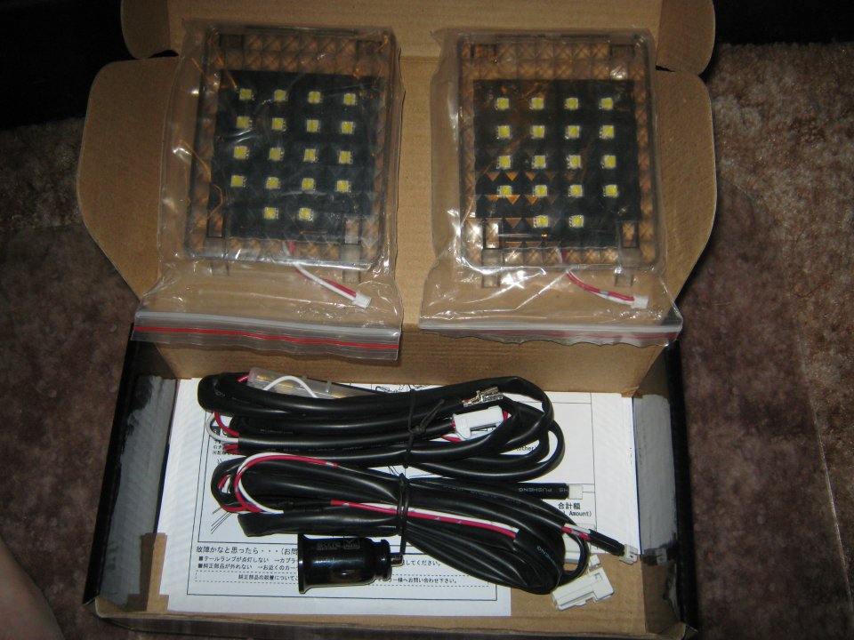

    Rear Hatch Cargo LED's:

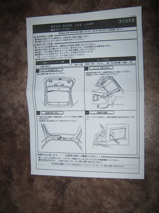

    I received a set of LED's for the rear hatch last October. Been either lazy or intimidated to install them up until today. The weather is still warm and sunny, with a couple of extra hours of free time available, I began the installation process. The instructions are in Japanese and minimalistic, with little in the way of actual help. So you need to be creative with your installation.

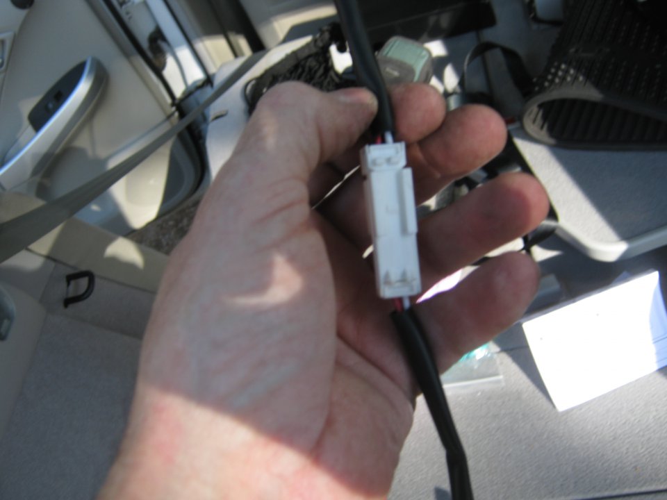

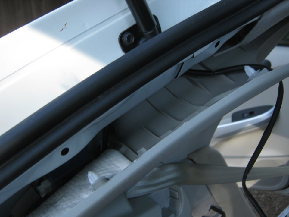

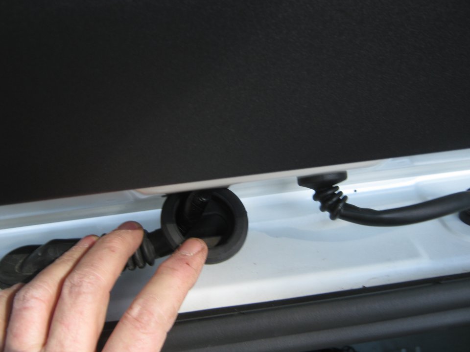

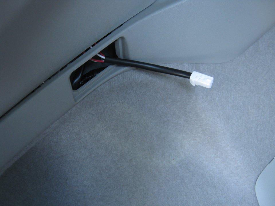

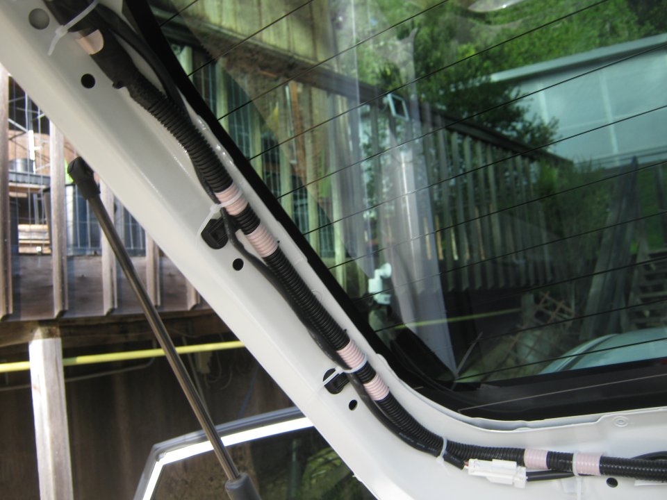

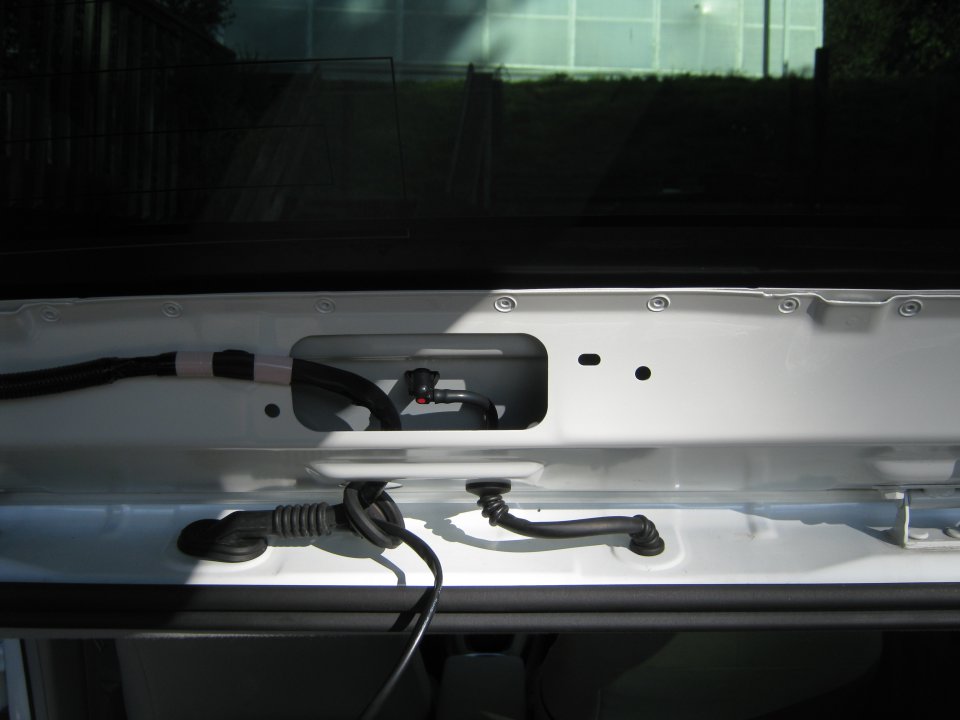

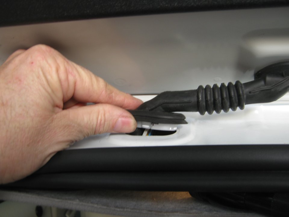

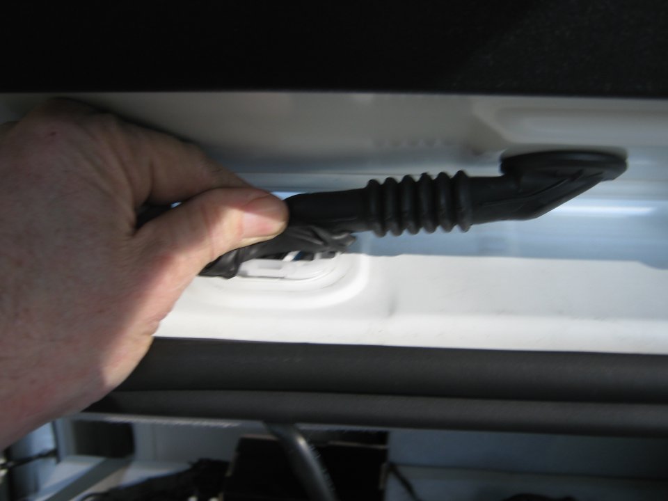

    Best to begin by removing the interior panels from the hatch and accessing the rear cargo light. There is a small recessed area near the switch to insert a panel tool to remove the light. The hatch LED's come with a wire harness that contains a plug that connects directly to the rear cargo light's plug and splits it into a fused harness for the pair of hatch LED's and a second plug for the stock cargo light. I cheated and only raised the interior panel's edge above the cargo light, to drop the harness down into the area behind the rear cargo light. Running the harness to the rear hatch, I lifted the edge of the roof panel to run the harness to the rubber boot connecting the interior and the hatch area. The roof side of the hach has a plastic insert that can be lifted by releasing several tabs to make running the harness through the boot easier. Wiggle the top part of the boot to remove it from the hatch and insert the LED harness through the boot.
    IMG_4372.JPG IMG_5461.JPG IMG_5464.JPG IMG_5468.JPG IMG_5462.JPG IMG_5466.JPG IMG_5499.JPG IMG_5472.JPG IMG_5475.JPG

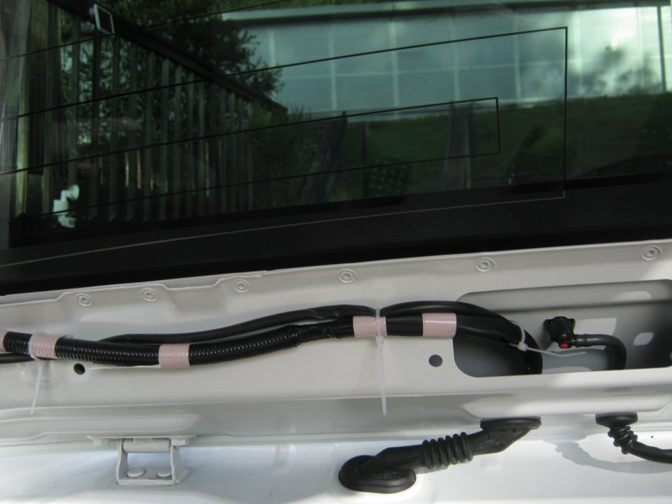

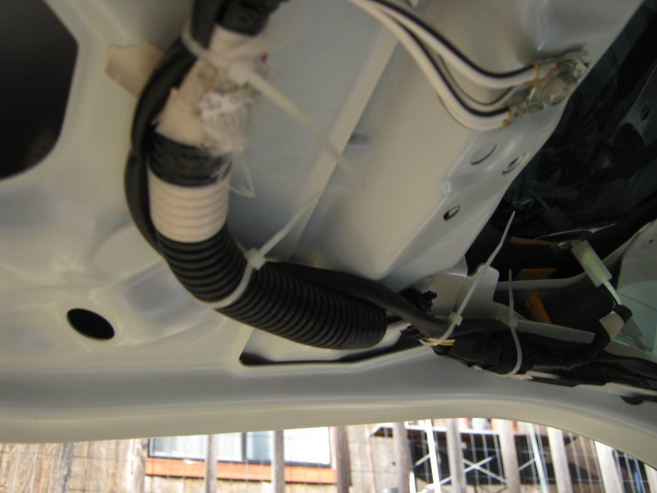

    Armed with a bundle of mini zip ties, I let my OCD run free and routed the LED harness along the existing harness. :rolleyes:

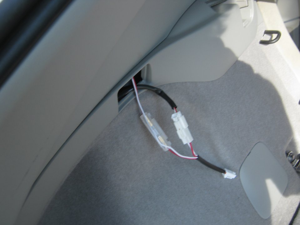

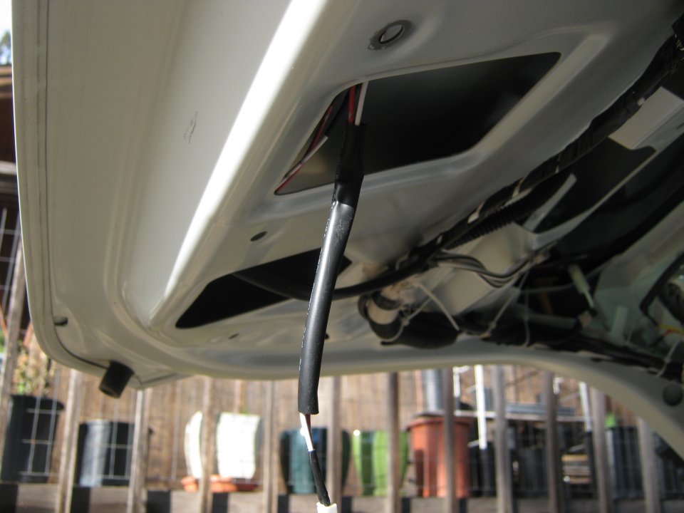

    The LED harness comes as two pieces. This allows you to run the harness through the boot. A plug(included), seen in the lower right of the third thumbnail, has to be attached to the metal pins and connected. Make sure you have the correct polarity, red to red and white to white, before inserting the pins into the plug. After routing the LED harness, drop the small plugs out the pair of rectangular holes, approximately 3" x 4" in size, just to the sides of the center.

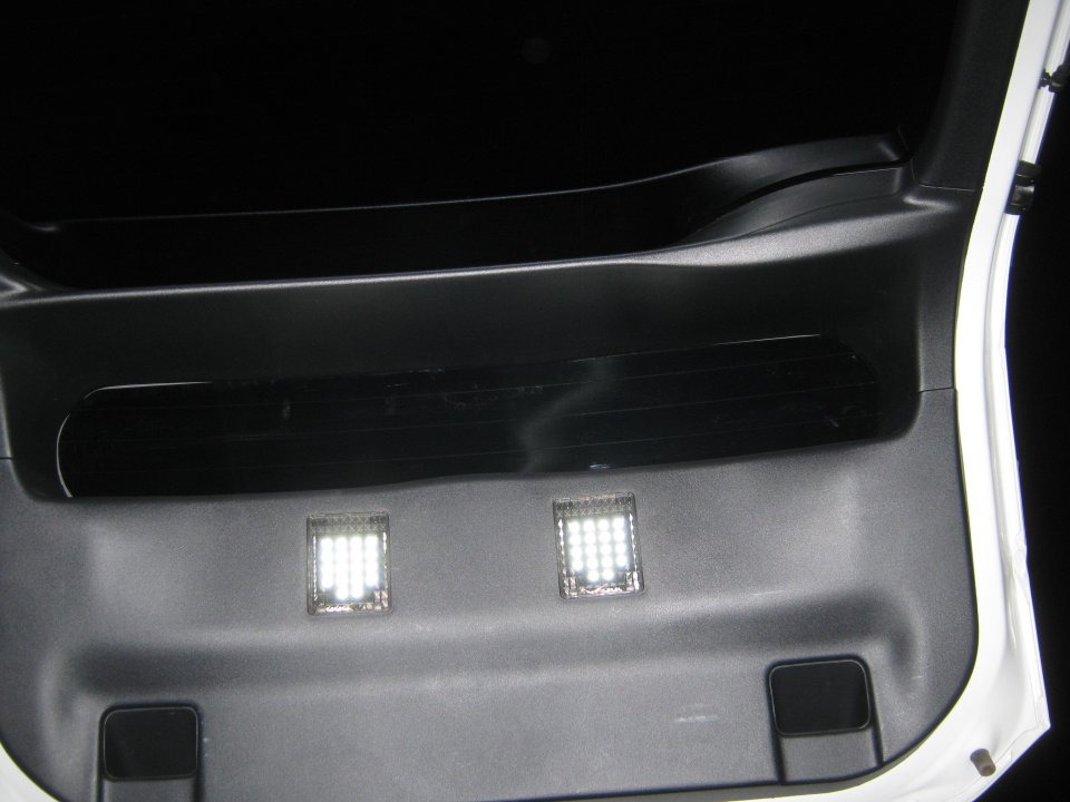

    Unfortunately the LED's wire harness shipped with a broken/blown fuse, so I used a multimeter to test for voltage at the LED plugs before reinstalling the hatch interior panels. Once reinstalled, the LED's simply plug into the harness and snap into place, using the existing panels that allow access to the License plate light sockets.

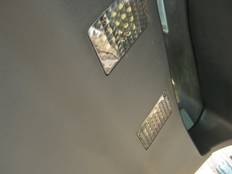

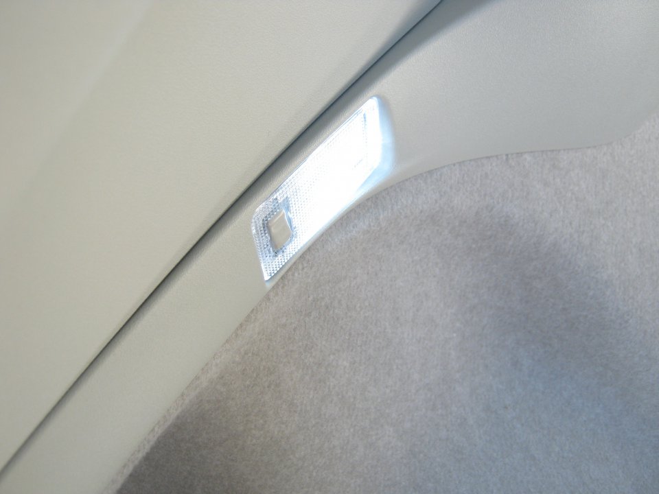

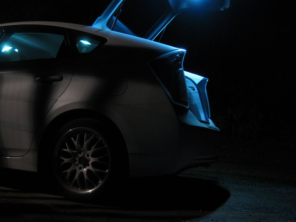

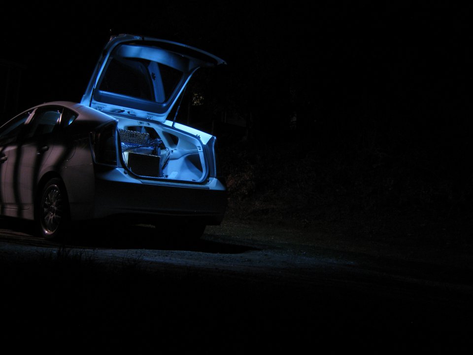

    Hatch Cargo LED Update:
    Replaced the fuse and the rear hatch LED's light the entire cargo area. Much more effecient than the single light on the side. The rear hatch LED"S light independently of the cargo light. The cargo light works with the switch. While the hatch LED's operate with the hatch, on when open and off when closed. (y)

    The hardest part of it all is getting the LED harness wires through the boot. Not much room to work in the crease with the hatch open.

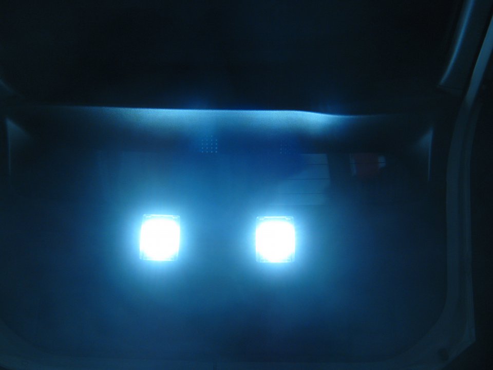

    Images of the Hatch LED's at night:
