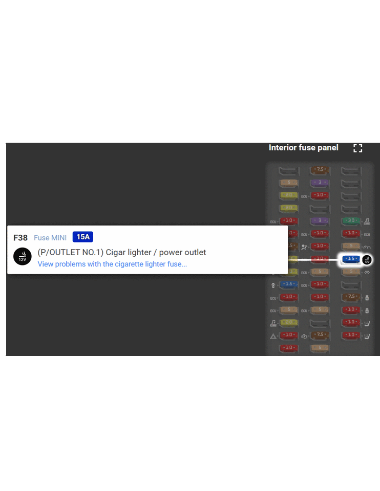

    Second, I lost all power to the 12V power socket. I assumed (correctly) a faulty fuse, and I was fortunate to have someone replace it for me in under an hour. I had wasted over half an hour trying to find the fuse location and gave up. Well worth the $35.
    Thirdly, I noticed my cooler had stopped working. The auxiliary battery I had installed was dead flat. I found out why; it was no longer connected to the 12V system. Apparently the dealer had left everything unplugged in a contemptuous fashion, as they often do. I'll have a job today connecting it back up.

  8. Paul Gregory
    Paul Gregory Senior Member
    Dec 9, 2022
    2,329
    610
    Alberta
    2024 Prius Prime
    XSE
    RandyPete, PrimeDan and otatrant like this.

  11. Hammersmith
    Hammersmith Senior Member
    Jul 26, 2021
    2,435
    2,500
    North Dakota - USA
    2023 Prius
    Limited AWD-e
    It's called the Power Distribution Box Assembly and it's attached to the Main Body ECU. Being a fuse panel is only one of its jobs. Just do a google search to find a video showing a Toyota PDBA or interior fuse panel. They're pretty much all in the same place.
    And it's location is in the owners manual, of course.
  12. RandyPete
    RandyPete Active Member
    Apr 1, 2021
    409
    171
    Santa Margarita, CA, USA
    2024 Prius Prime
    XSE
    No luck using google with the term power distribution box (PDB) for a gen 5 prius. Found it for earlier model prius, but not gen 5.
  13. Hammersmith
    Jul 26, 2021
    2,435
    2,500
    North Dakota - USA
    2023 Prius
    Limited AWD-e
    Which is good enough because it's in basically the same place on most modern Toyotas. Under the dash, just to the left of the steering column. Just stick your head under the dash and look up. There's a white rectangular cover with the fuses labeled on it. Easy enough to spot because most everything else up there is black. Pop off the cover and the fuses are underneath. If you need to pull one, grab the fuse puller from the engine compartment fuse box because there is no way to pull one of those tiny things with your fingers.
