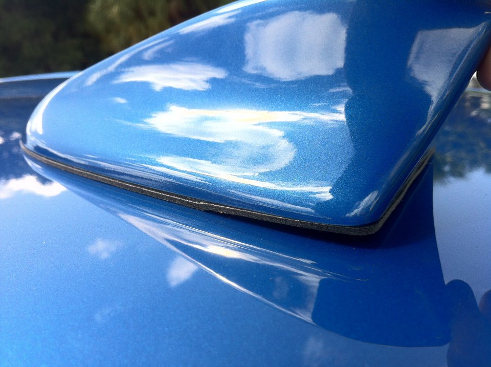

    Wow it does appear to be a bit shorter, I do see the curve in the back. I wonder how that makes more room inside for the antenna base? You'd think that'd make the problem worse. Thank you for taking the pic. I'm a bit confused, you ordered one from this site and received it, to find that it didn't fit because of the sunroof? Or did you specify you had a sunroof? I didn't see any different options when I ordered, but it is possible I ordered wrong. image.jpg

    No, this was July last year, not all that long after the C was first on the market, and I ordered the standard shark fin for the C as soon as it was available through the PriusChat shop. When I installed it I found that I could get either the front or the back to stick down, but getting both at the same time required deforming the roof.
    I then made the assumption that the shark fin had been designed for the C without the sunroof (thinking that VG must have know what they were doing when they made it but perhaps hadn't tried different versions of the car). So I sent a photo to VG showing the gap at one end when the other end was secure. They asked me to return the original and sent a replacement with the base cut in a slight concave curve (as opposed to the flat base of the first one). That one was a good fit, and is the one in my photo.
    If they're now proposing to use a thicker adhesive gasket, that would presumably also work.

    Cool, I'll report back here with the results when I receive it from them. Thanks for the help
