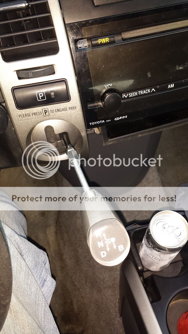

    So I got a 2008 prius to borrow from the boss for a trip to the sema show in a couple days. Immediately I noticed how lame it was to put it from R to D or down into the B setting. Had to lift your arm to reach the shifter.. Went to the hardware store and for roughly a buck fifty I had a comfortable shifter for the trip (northern Cali to Vegas a 13 hour drive) here it is.
    It could use a slightly lighter knob but its not bad at all. A worth while mod in my opinion!

    Seems like a good idea, if your that lazy (lol) I'd be worried about breaking it off. I'd paint it also so it blended in.
    -on a side note I thought that was a beer in the Cupholder.

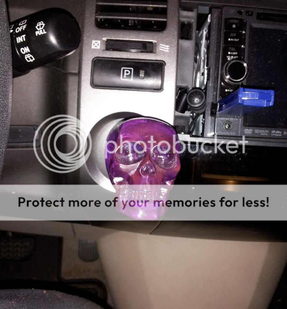

    bought it on ebay, drilled and tapped it 6x1mm. easy.

    yes. it has a standard metric thread pitch of 6mm x 1mm. if you have access to a drill press and a metric tap set, you could turn virtually anything you can drill into a shift knob. you don't want it to be too heavy though. this knob is on the verge of being too heavy; if I did it again I'd get one a little bit smaller. ebay has all sorts of potential shift knobs. the pre-drilled ones for normal shifters are drilled much too big for a prius and are drilled to be mounted on a vertical shift lever, so most of them wouldn't work well.
