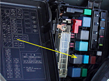

    I was just there yesterday!
    If you can actually select Park, then the shift control ECU is probably operational. I would just double check the fuse under the hood that feeds the parking system (30A?). Simple things first. You might want to check the PCON-MTR relay as well. Pull it at make sure the relay is good.

    Heads up but I sure the parking pawl is mechanically operated in our NHW11.

    Yup, I completely spaced that it was a 2001. You think that after all these years they would move the GenI forums out of the nested GenII forums...
