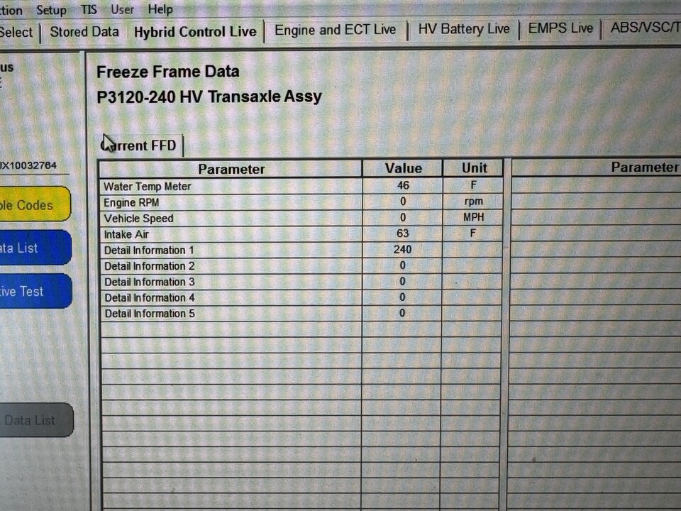

    Techstream shows P3120 with info code 240.

    That's an interesting code. 240 means "generator locked" ('generator' being MG1). At first glance, it would seem something has failed mechanically inside the transaxle, preventing MG1 from turning.
    However, "no reverse" would not be the only symptom of a really locked MG1. You wouldn't have forward either; there would be no starting of the engine, and the car would be hard to roll in neutral. It would be hard to turn the engine crank pulley with a wrench. You haven't mentioned any of those other symptoms. Do you have any of those?
    At least the vehicle speed and engine speed in the freeze frame are both zero, so that much is consistent, anyway.
