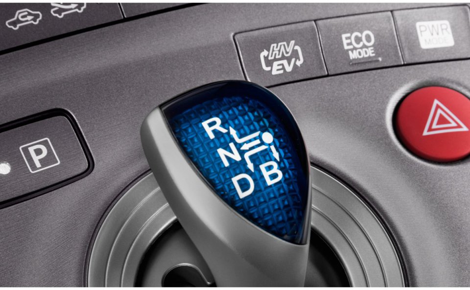

    Why do they have an N between R and D and what happens when you shift to the N position?
  13. JimboPalmer
    Apr 14, 2009
    12,470
    6,878
    Greenwood MS USA
    They are required by law to have N.
    49 CFR 571.102 - Standard No. 102; Transmission shift position sequence, starter interlock, and transmission braking effect. | LII / Legal Information Institute
    "A neutral position shall be located between forward drive and reverse drive positions."
    The Prius is always in Drive, all the other gears are emulations. In P a Pawl stops Motor/Generator 2 from turning. Since it is directly connected to the wheels, they can't turn either.
    In R, M/G 2 turns backwards, so the car goes backwards.
    In B, the engine will turn above 24 MPH as needed, to provide engine braking by pumping air fruitlessly. This lowers MPG, but can help keep your brakes from overheating, and again it is required by law. "In vehicles having more than one forward transmission gear ratio, one forward drive position shall provide a greater degree of engine braking than the highest speed transmission ratio" The Prius PHV seems to have a more robust B as it has a larger battery to dump regenerated electricity into.
    In N, no electricity is supplied or derived from M/G 1 or 2, so the engine may turn the planetary gears but has nothing to push against since the M/Gs are inert.
    You can neither start nor stop the engine in N, as M/G 1 acts as the starter and it is not powered.
    The big battery is not charged while in N, which can cause problems in car washes where the car has to move.
    There is no regenerative braking in N, since the M/Gs are not allowed to make or use electricity.
    The Prius PHV will have fewer issues with N, as it has a larger battery.
