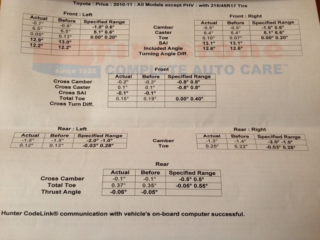

    SPC shims did not work for me, as they completely cracked when torqued to the Toyota recommended spec of 66 lb-ft for the rear hub bolts.
    The shims sold under the NAPA Chassis label worked great as they were much thicker and durable. They were also less expensive than the SPC shims, and since they are not two-piece, the shim spacers for the caliper bolts are also not required.
    The only downside is that you cannot get super precise adjustments with the NAPA shims but the increments are not too bad.
    I previously had 0.33-0.35 on the LR corner. I cut the NAPA shim to reduce the toe-in by 0.19 and this was the result:
