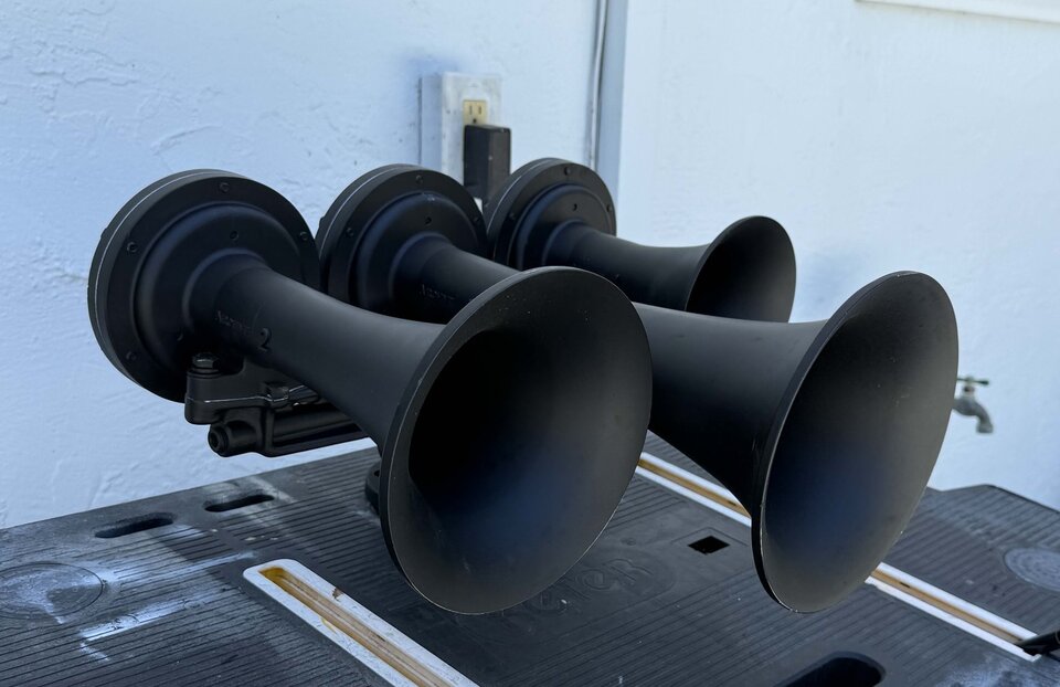

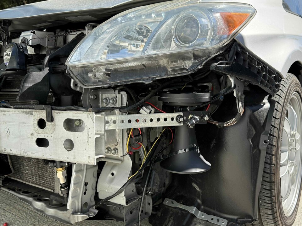

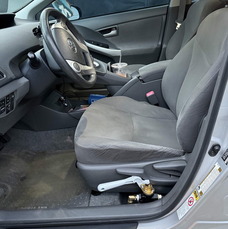

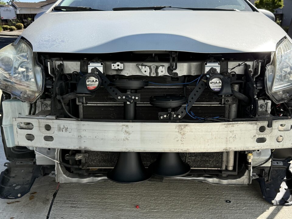

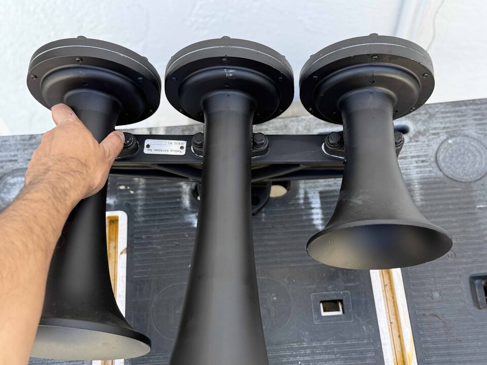

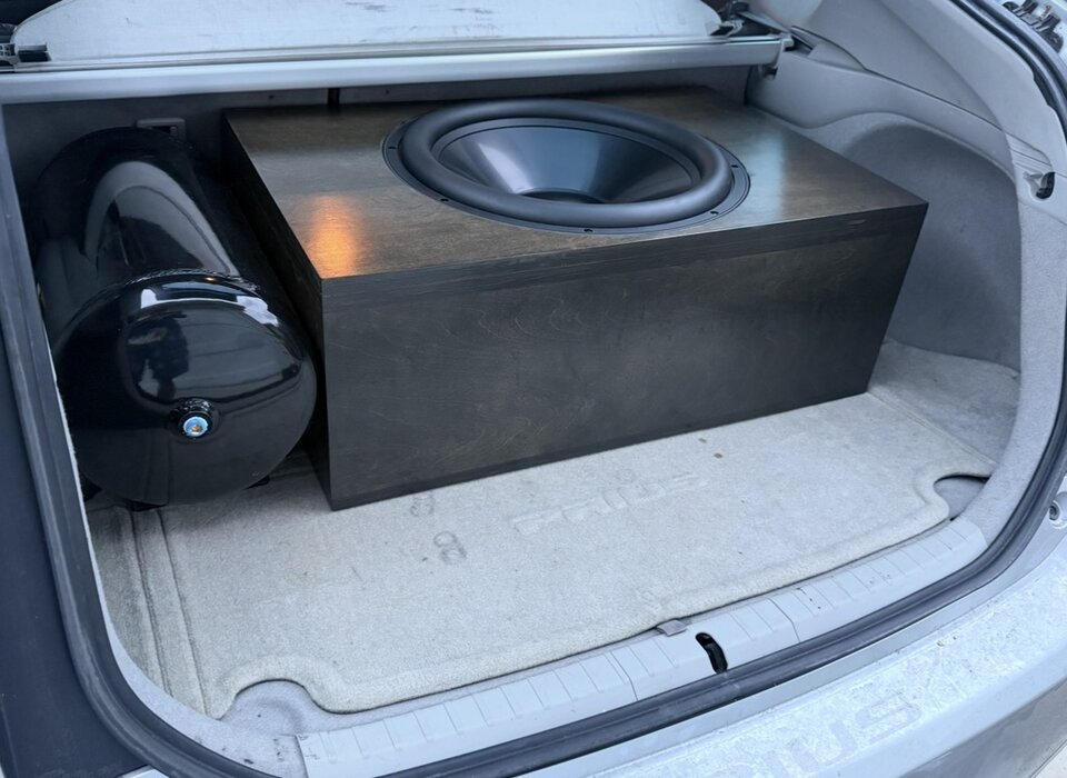

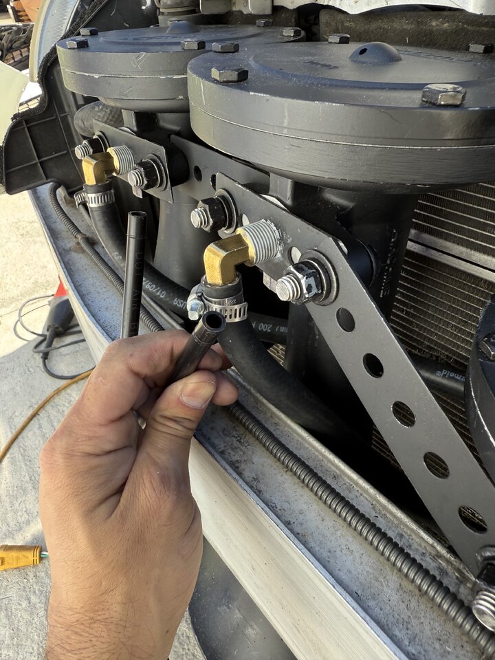

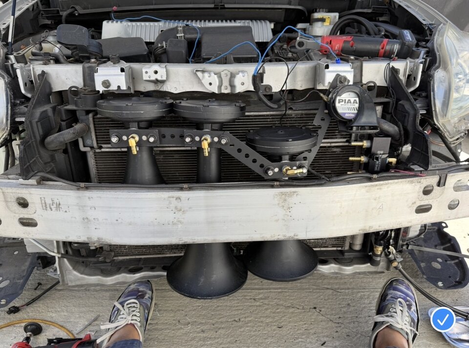

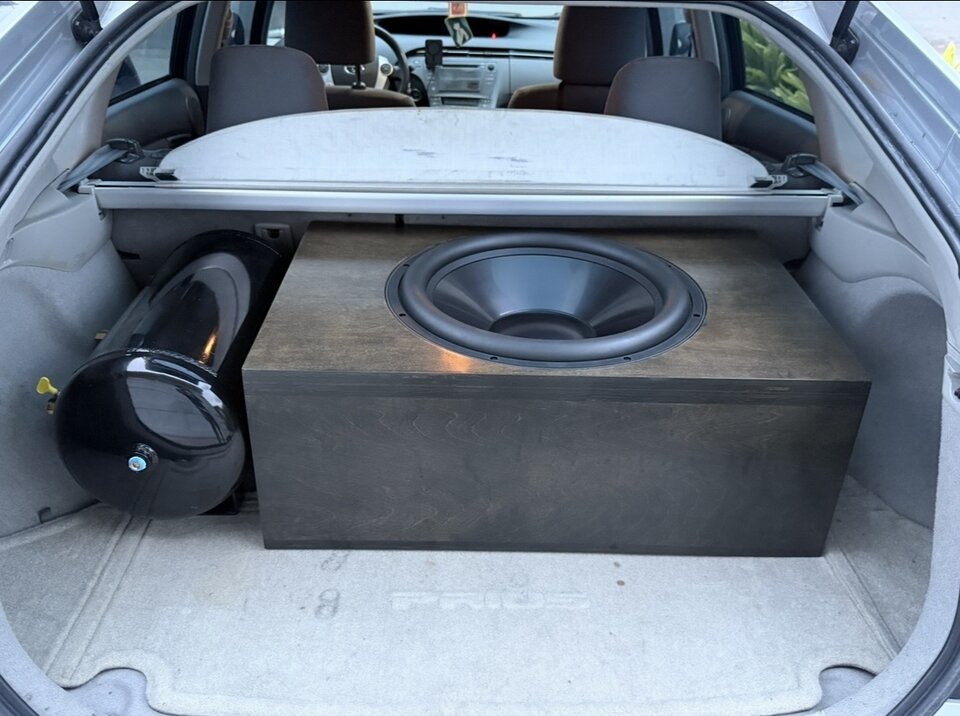

    Installed and its loud asf, perfect for me.
    at first installed an electronic air horn; cheap one from amazon for $45 bucks or so.. it was ok in conjunction with stock horns and slightly louder, however this was not enough for me.
    - Horn blasters Shocker XL
    - Firestone 2 gallon 2 port 1/4 npt air tank
    - Klein 6270rc air compressor
    Screen Shot 2025-03-19 at 10.37.31 PM.png Screen Shot 2025-03-19 at 10.36.39 PM.png Screen Shot 2025-03-19 at 10.47.46 PM.png Screen Shot 2025-03-19 at 10.38.30 PM.png Screen Shot 2025-03-19 at 10.38.05 PM.png IMG_4851.jpg Screen Shot 2025-03-19 at 7.51.26 PM.png IMG_4669.jpg

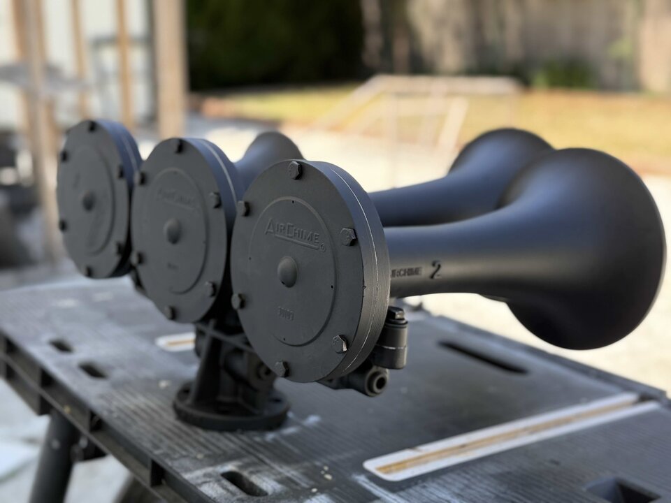

    update, added this Nathan K3 train horn, tbh i was underwhelmed and went back to the Shockers.. but heres some install pics
    IMG_5467.jpg IMG_5468.jpg IMG_5469.jpg IMG_5519.jpg IMG_6342.jpg IMG_6345.jpg IMG_6346.jpg

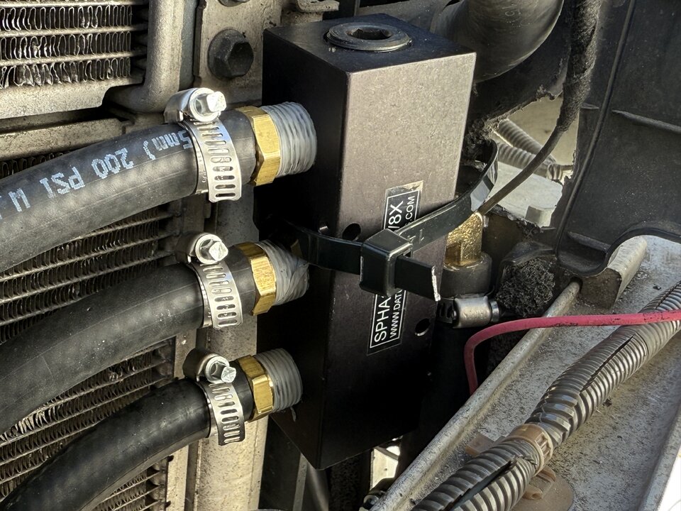

    upgraded to 1/2 ID hose from tank to valve.. and then 3/8 ID from manifold to horns.. this setup really lets the K3 horns sound loud as they should. Also upgraded to a single 18 sub
