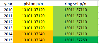

    From what's been reported here more recently, regarding the revised oil ring being wider, I think now it's very likely the pistons and rings were revised at the same time, some time through 2014 model year.

    My '14 was produced in March. That means I have newly improved rings and pistons... or neither?

    Near impossible to tell, and to what end?
    On this Toyota parts site, model year 2014 shows both old/new pistons/rings:
    CRANKSHAFT & PISTON. 2014 Toyota Prius Three HYBRID | Toyota
    But no indication about production months. And no clarification, ie: which goes with which. From what I've heard hear, I don't think you can mix and match, it has to be old pistons and old rings, or new pistons with new rings.
    I woudn't sweat it.
