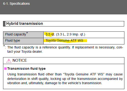

    The engine and transaxle are similar to gen 2 Prius. Prius c Owner's Manual says (on page 502):
    It may have distinct drain/fill bolt types, so good to have another vehicle available, in case you need to score an extra socket. At least for first time, I'd get the fluid and fill/drain bolt washers from the dealership, and note the washer part numbers.
