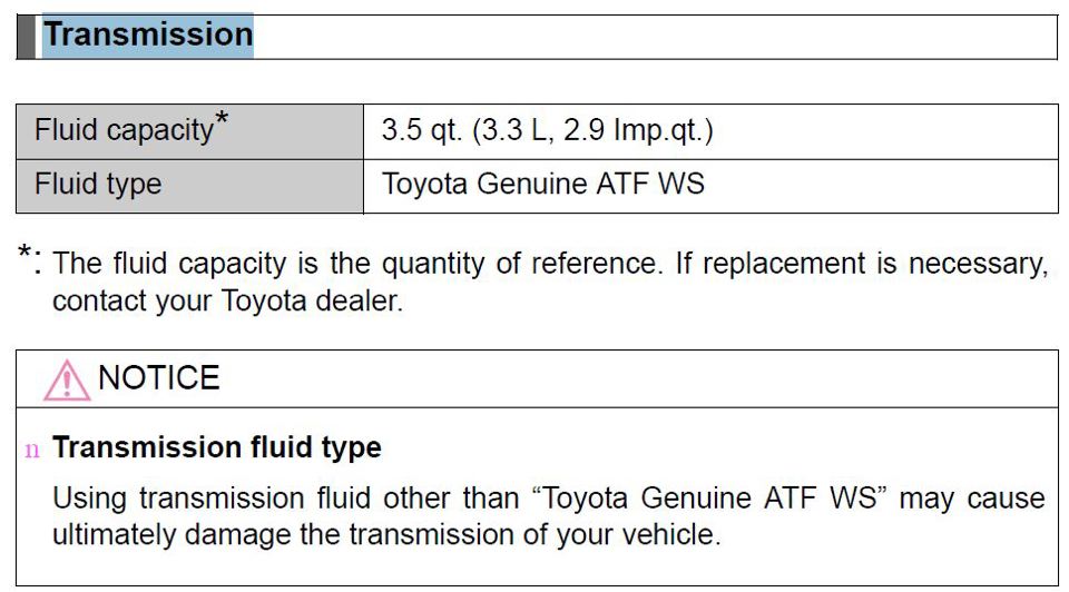

    Once again this manual also does not schedule any ATF changes. Why?
    And just in case you missed it, there is some Chinglish going on here !!!:LOL: :LOL:
    Trust them...
