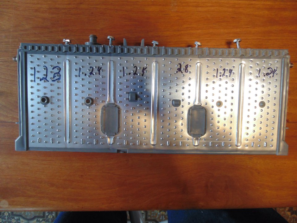

    I have had very different results from letting battery modules sit for extended periods. Before I purchased my first Gen I Prius I bought thirty good modules from a failed pack. My plan was to use them for electric bike projects. I did not end up using the modules for bikes. They were all used to repair other Prius batteries. Those modules sat for four to five years and held at over seven volts. Self discharge over extended periods is an good test. I will not attempt to use any module that can not hold at over seven volts for extended periods. Grid chargers can "prop up" weak modules but it is a losing battle. I have started an experiment to see what is happening at the cell level inside the modules. The picture shows a module with sheet metal screws contacting the cell interconnections.
