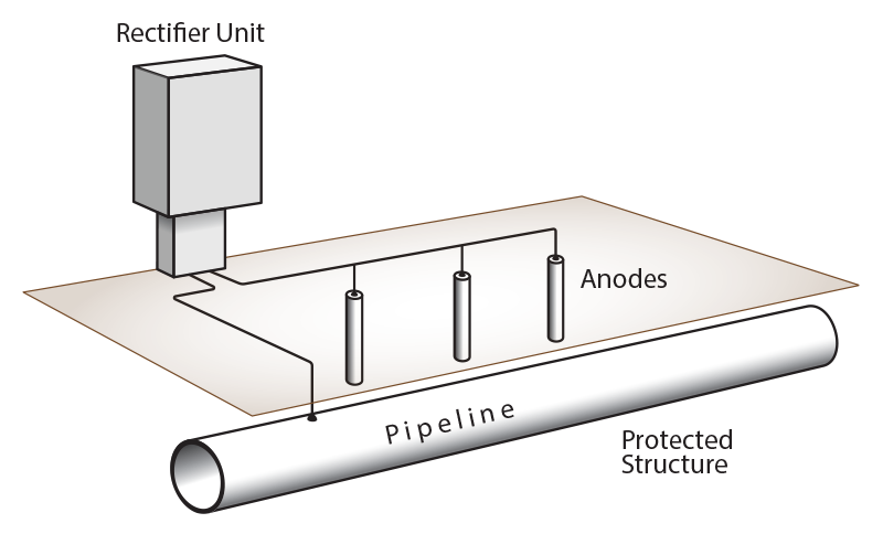

    That describes the "sacrificial anode" kind of cathodic protection, where the protective current flows just because of the voltage difference on the galvanic series between the steel you want to protect and Al/Zn/Mg. What you've built is a DC battery, which eventually poops out as the anode gets eaten away.
    There are also impressed-current cathodic protection systems, where a DC power supply is used along with anodes of a durable material that isn't eaten away. The DC power supply is what makes the current flow.
    They're used a lot to protect underground tanks and pipelines. The anodes are buried near the pipe or tank, so there is a voltage gradient through the soil between the anodes and the structure.
    Not sure how you'd make that work with a car.
    For a car in a stationary application it could be easy enough.....
    If you're serious about an impressed-current cathodic protection system, there are official ways of testing it to be sure it is doing what you want.
    Interestingly, this auto product's web site does have a link to a patent. Also interestingly, the web site gives installation instructions that seem to pertain to something not at all like what the patent describes. (The patent describes odd spring-loaded moving electrodes used to inductively couple a current, and some kind of conductive body sealant. The installation instructions talk about to gray wires you screw to your sheet metal.)
