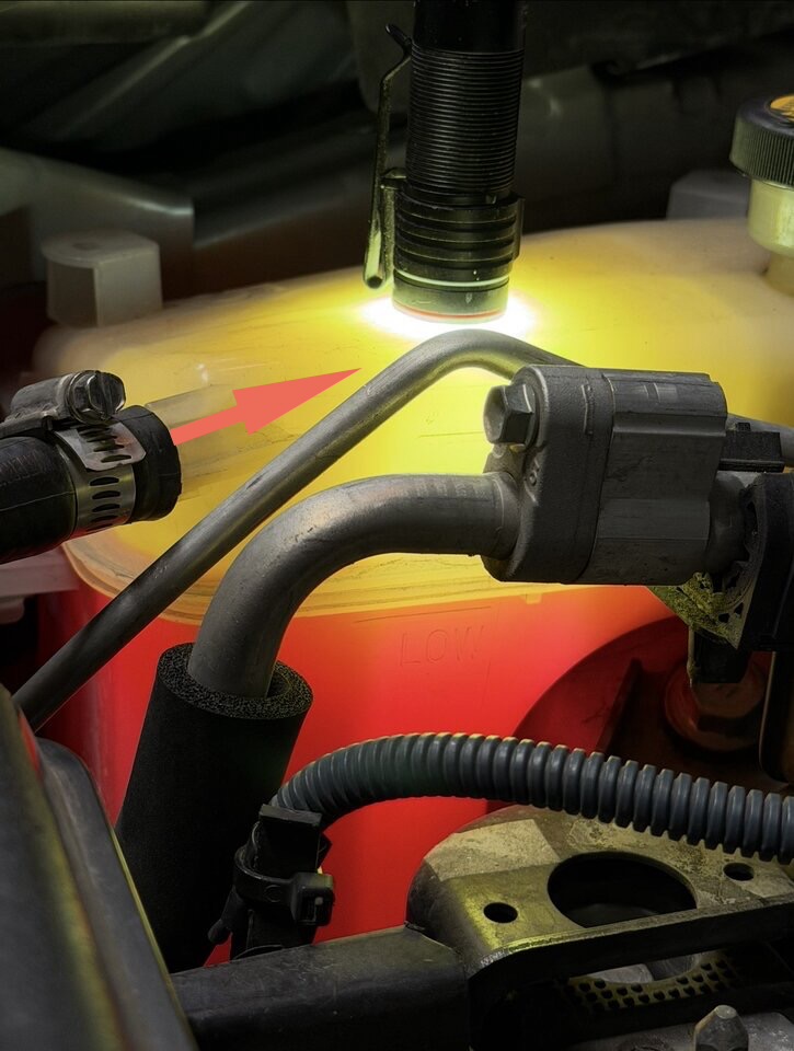

    Water pump flow should be visible in the reservoir when warmed up.

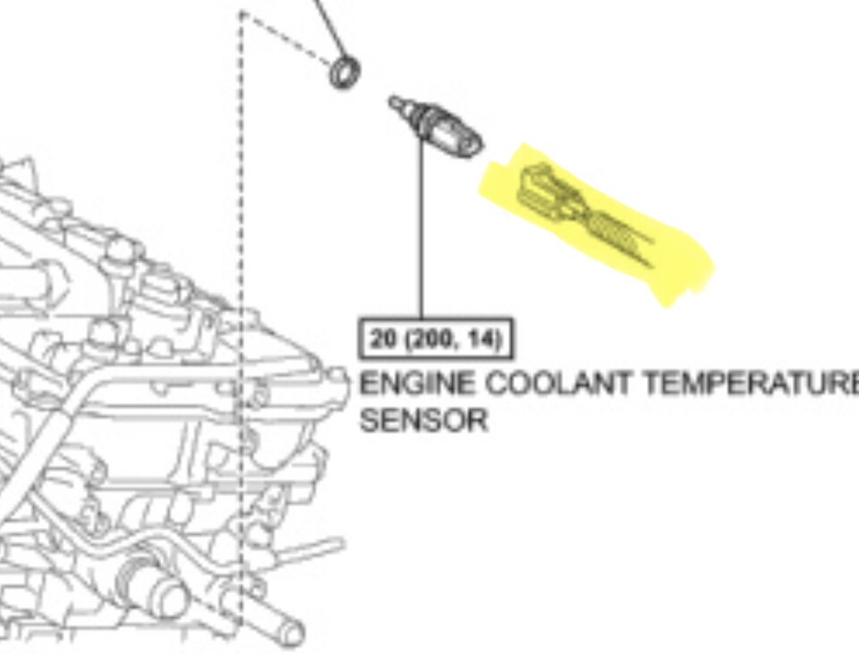

    The temperature sensor code by itself could be air in the system or a wet connector. Might try a hair dryer on the connector near the radiator hose attached to the engine.

    Or just use the undisclosed scanner to view the temp sensor reading. If it's something close to the right temperature you expect when the engine has been off and cooled to the temperature of the surroundings, then you don't have to spend much time on the possibility it's a wiring or connection issue. It is probably also right when the engine is running and it's saying the unpumped coolant is too hot.

    Good call, there was definitely some air in the system. Nice technique with the light on the coolant tank.
    Its basic Chinese ELM327, ECU reported around 180-220°F but I don't believe it. Definitely saw flow in the coolant reservoir but probably insufficient.

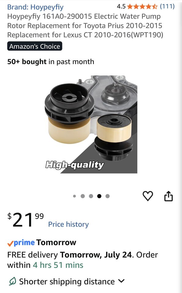

    The rotor seems to be the failure point. I got an Amazon pump with a metal rotor, claim is that the metal one is more durable? Metal rotors are cheap too. The Autozone $500 pump has the plastic rotor.
