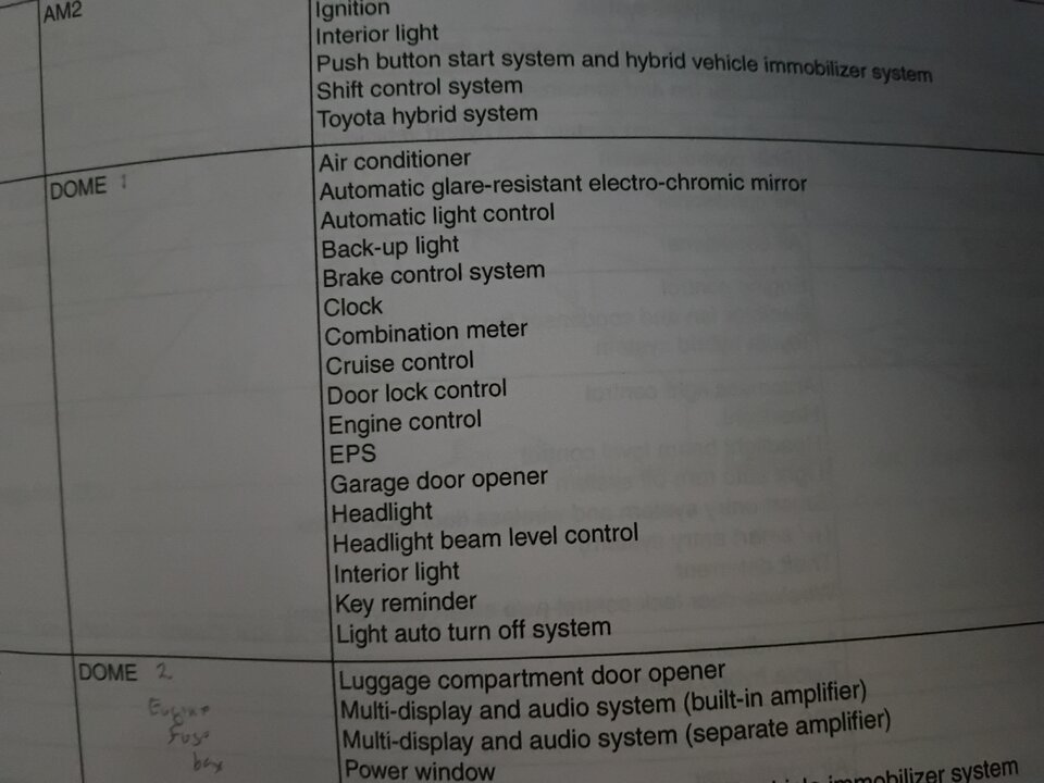

    The dash is easy to remove. After doing it once and following a youtube example. The first time took me an hour. After that, fifteen minutes (because I realized how easy it is so I did other things later.) Now, soldering in that cap is NOT easy - I did it, have some experience with tiny circuit board soldering and found it not easy at all. One person on you tube got another board from a company that fixes those Prius circuits. There are hoops to jump thru to do that but worth it not to put up with that problem and soldering.
    By the way, the circuits that the dome light's fuse protects are a lot of important systems. I would not by-pass that fuse considering the risk to those items.

    What else is on that circuit? Some of the computers start glitching at I think 10.5 V or so, and if there is a diode in line then there is 0.7V less headroom for any computers on that circuit with respect to the 12V battery voltage at startup. End result would be that a weak battery could start causing real startup problems at a higher, but still quite low voltage. Not a difficult fix though, just replace the 12V a bit earlier than letting it age to the very edge of uselessness.
