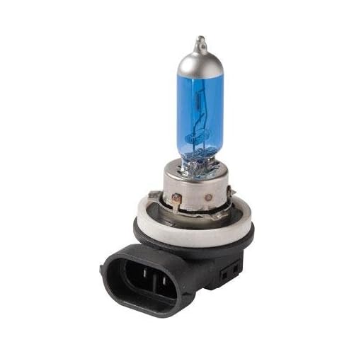

    So your kit has the H11 bulbs?
    Great, I ordered a high end vled h16 bulb and of course it sounds like it was not correct?. Are h11 and h16 interchangeable - just a different output rating? Seems odd that they would have a different bulb # for output.
  5. ztanos
    ztanos All-around Geek!
    Jan 10, 2013
    3,339
    1,150
    Cumming, Georgia
    They are not interchangeable.
    H11 has this connector:
    While the H16 bulb has this one:
    It looks like the connector "might" work, but the bulb won't mount into the H11 slot.
