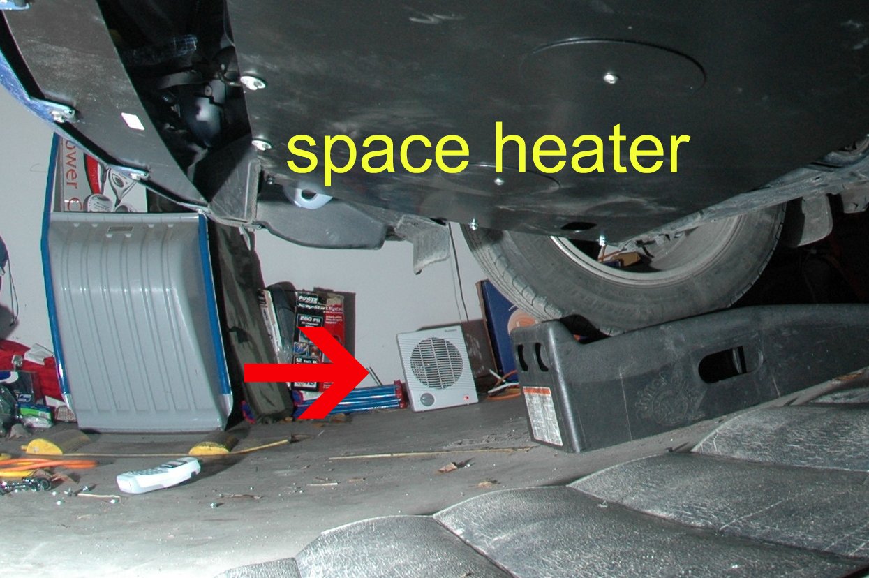

    Found another image.
    @dpower curious if your original bt skid plate came with the left/right wheel well 'wings", seen mounted above.
    My unused plate didn't come with such, and was curious if they were mission critical to the installation.

    Well that sucks, and thanks for the heads up, guess demand isn't what it use to be. Wonder if the gen3 plate is still available. After looking at the mounted gen3 product image I want to know what those "Red" fasteners are, or where to source those at.
    I still have a secondhand (unused) BT skid plate laying around, and my idea was to use it as a template to make a couple prototypes from, but it appears to be missing those two "vertical supports" (image above) and the mounting hardware, like the black "clip on" nuts(?)
    If someone had the vertical support pieces, that would make the project a bit easier. Could even try to redesign the plate and have it attach elsewhere under the gen2, even if it increased the size/cost of materials and shipping.
    Would also be great to figure out a quick release fastener/mounting option, but that is probably pushing it without additional help/input.

    [QUOTE="I still have a secondhand (unused) BT skid plate laying around, and my idea was to use it as a template to make a couple prototypes from, but it appears to be missing those two "vertical supports" (image above) and the mounting hardware, like the black "clip on" nuts(?)
    Would also be great to figure out a quick release fastener/mounting option, but that is probably pushing it without additional help/input.[/QUOTE]
    make some templates from cardboard for the side plates, and if you don't have the tools to cut, bend and drill them, I'm sure you can find a metal shop that can do that from your templates.
