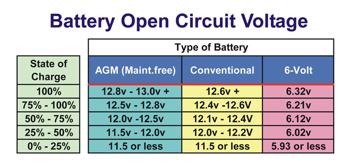

    On another note, the chart below will give you an idea of what voltages mean concerning amount of charge in your battery. Your battery is a AGM type. Remember that the voltages referred to are measured at the battery terminals in a open circuit with a digital volt meter. In the Prius, the voltage will read about .2 to .4 lower due to draw on the battery by onboard devices.

    Since you have now seen that the battery won't hold a charge as evidenced by the 12 hour period, I think you are on the right track now.
    Many here on this board including myself regularly top off the 12 volt with a good smart charger. If you get into that practice, you may find that the new battery will hold up better over the long haul. The battery in our Prius is 10 months old now. I have topped it off about four times now with the Battery Minder I have. It usually only takes a few minutes to bring it up to full charge.
    Our Prius sits at times for two or three days as I don't commute daily to a job any more. Since I leave the SKS system on all of the time, I have to keep an eye on the voltage. I don't want it drop a lot since wild swings in voltage can contribute to the sulfation process.
    The product you linked would work great if you were running it on a alternative power source. I believe it basically does the same thing that ours does. The difference I think is the power source. Mine runs on 120 volts. I bought it originally to try to revive the old battery. I nursed it for seven months before finally deciding to change it on a cold rainy morning last January. Glad I have a carport to work under.
    Whatever you do, make sure the battery you get is fully charged before you install it. Check the voltage at the post's before you hook it up. Remember that a fully charged AGM type battery should read at least 12.9 volts. Optima should read 13.1 as well as the Toyota True Start.
