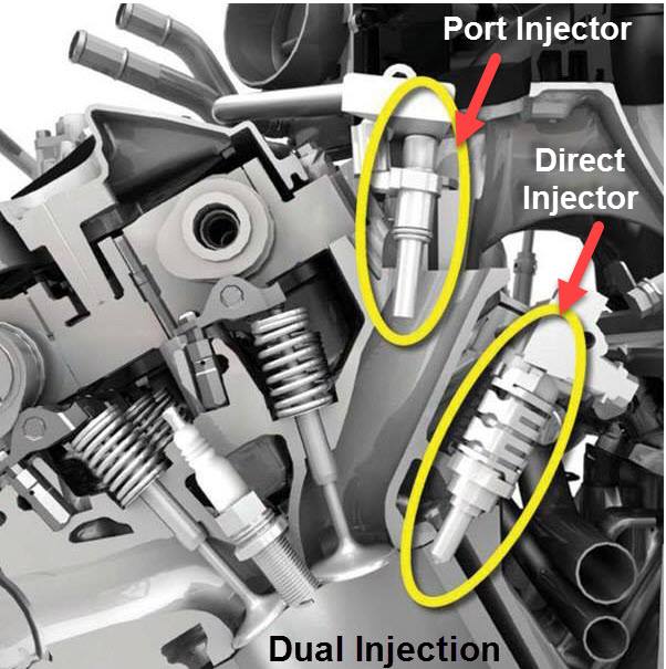

    Toyota went dual injection along with electric motor intake valve timing and hydraulic exhaust timing for various reasons. Dual injection to solve direct injection's carbon buildup which previously required walnut blasting to effectively clean without disassembly.
    The upgraded variable valve timing along with dual injection delivered an Atkinson cycle engine which can provide low end torque, huge hp with battery support (well over 300 hp in a Rav4 plugin) and excellent mpg in a heavy suv.
    All of this does complicate the powertrain tremendously yet Toyota has not had problems with it in more than eight years of sales on a high volume platform, now including the gen5 Prius.

    Yeah, double the injectors for starters. What's their motivation for dual injectors, maybe a few tenths of a mpg?
    Addendum: Google's AI response (to "why are auto manufacturers using port and direct injection instead of just port injection") lists various benefits.

    Second paragraph post 31.
